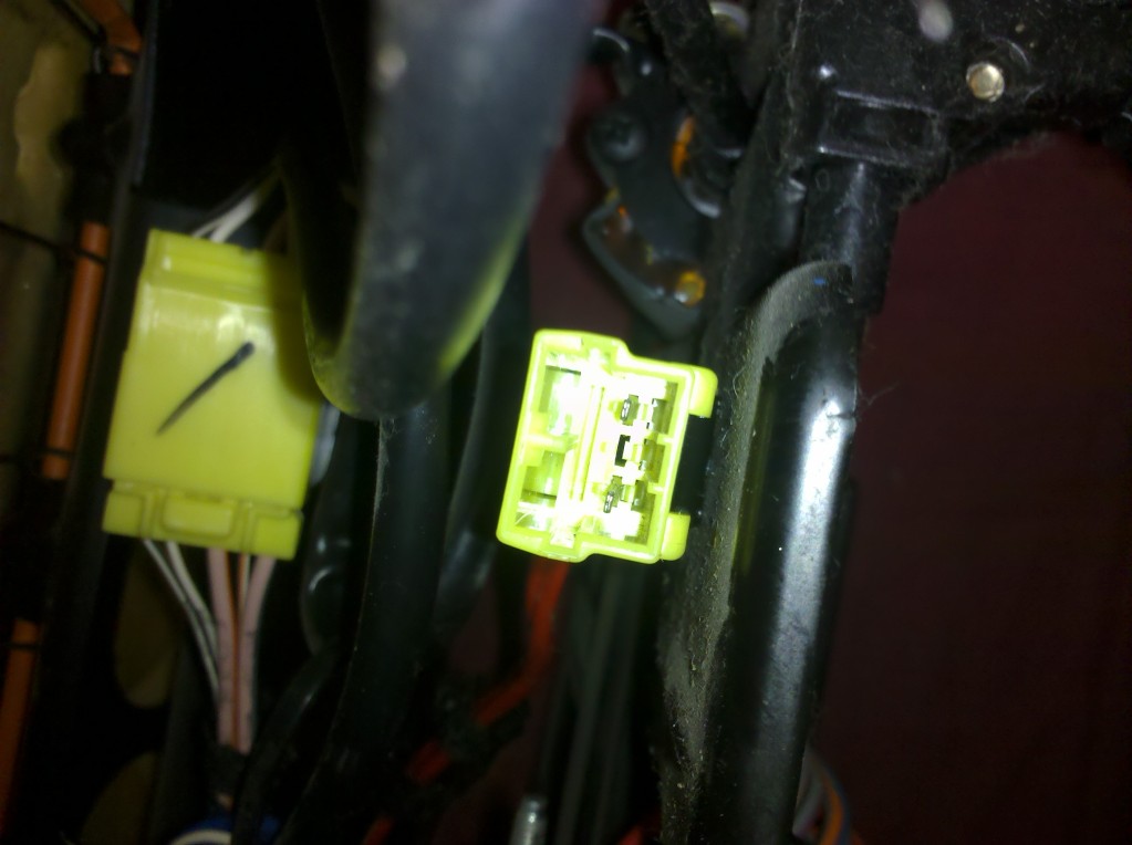

However, at some point a previous owner maybe effected a clock-fix by fitting the heated seat version of the clock panel. So I get the light, and I hear a relay click, but I have no blankets - at least on the driver's side. Driver's side - relay click sounds like it is somewhere behind the dash, while on the pax side, it is in the seat memory module. On the driver's seat, I have only two open plugs, a yellow under the seat cushon mounted to the frame, and a gray, also mounted to the seat frame behind the squab cover. Both are 2-pin with fairly heavy-guage wire:
I have checked the yellow connectors on both sides (Driver's and pax) with a meter and neither get power when the seat-heater is switched on. I have also checked the gray plug on the driver's side with the same result. The electrical guide has been scant help only listing seat-heater relays for "Non-us spec, non memory seat" cars. Apparently, the heater function is handled in the US spec cars by the memory module.
I know several of you have replaced the heater-blankets to repair your heated seats. Did anyone snap a pic of where they plug in? Or remember the location and type plug? I'd just be surprised if that circuit weren't already living in there somewhere, seeing as how everything else seems to work. If so, I'll fit an aftermarket blanket, if not, I'll put it all back together when I get my repaired cover back...it is TX after all, and they are hardly a necessity.

Popped the X300 disc in this afternoon thinking, "Information on seat wiring can't possibly be as sparse as it appears..." and as I was perusing 15Electrical.pdf, lo and behold, my eye caught on the following:
Note: "Fault conditions and their causes displayed by instruments and warning lamps are covered in more detail by further information contained within the "Electrical Diagnostic Manual."
I toggled back to "FLASH" and sho'nuff, the very next door neighbor of "Vehicle Service Manuals" was "Electrical Diagnostic Manuals" clicked on it and brought up "INDEX" which told me heated seats were addressed in 15.4-17. Back to the FLASH menu box and hazard a guess on "ELECTRICAL" as nothing else seemed to fit, which opened 07ELECTRICAL.pdf and Bob's yer uncle, right there in living black and white...connector diagrams and pin-outs, test protocols, all the good stuff - now if I'd just found that while I still had the seat out.......ah well...think I'll pull it out again before it gets cold to do the headliner anyway, but I think there is enough there to get it sorted and put those new carbon-fiber blanky's to use. We'll see - btw, my car, sans heating blankets, passed all the tests except the seat actually heating up!
