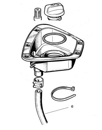

Check the bottom of the drain tube (item 6) from the filler bowl where it emerges under the vehicle next to the diff:
The top of the tube in the filler bowl is usually clear but the bottom often blocks with dirt/mud. A thin wire will clean it.
When the tube is clear you should be able to run a hosepipe into the bowl and it will drain OK.

Thanks Graham I used my air compressor to clear the drain then put a bottle of de-icer in the tank left it sitting overnight and it worked great.
Seems silly to have placed the petrol filler on the top instead of the side which asking for the problem with rain water to happen. Especially when the car was built back home in the UK where it rains most days...lol
