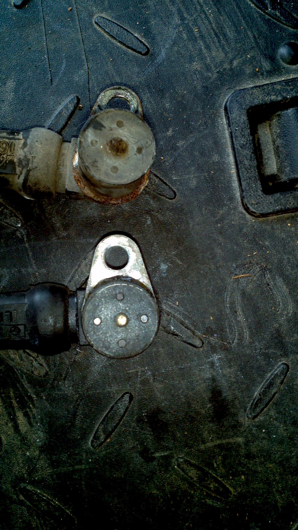

jaguar xj6 rough running - YouTube
A video of the engine trying to run from cold,also changed the Crank sensor as I read somewhere here that it could be the issue sad face no joy.
pic of the old crank sensor.
where did u get urs and how much did u pay?
your old one looks like **** lol.
