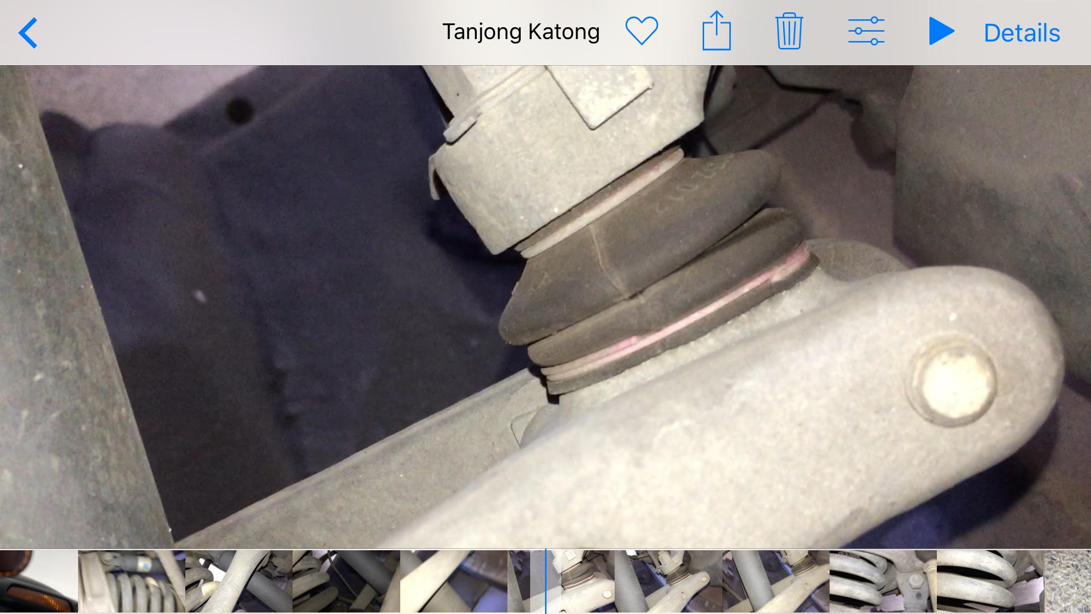

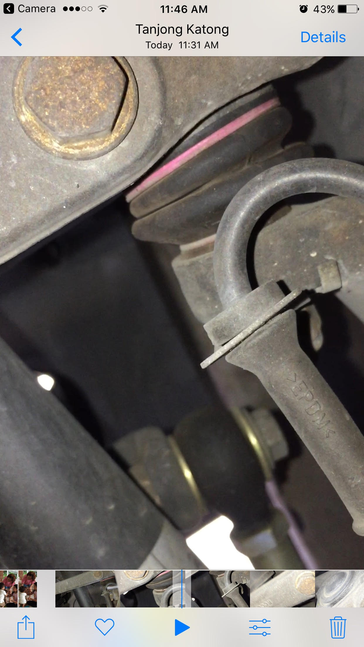

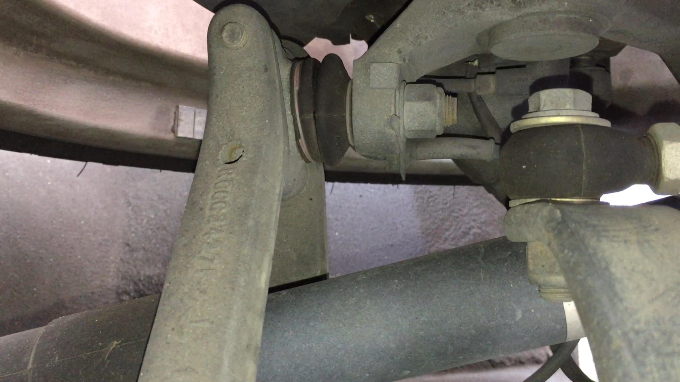

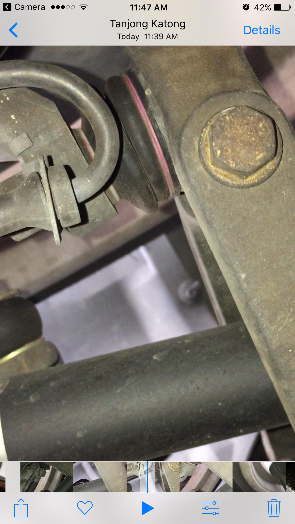

2) Upper ball joint - It's the only part i forgot to replace when I did all the suspension work! Took some photos/
