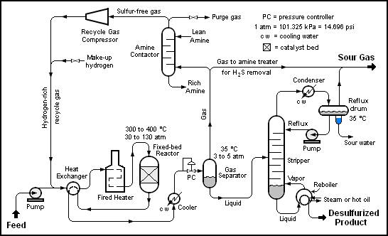

Nikasil was cause by the sulfur content in fuels . Crude oil comes out of the ground ground as sweet or sour depending on the amount sulfur content as it comes out of the ground . One of the reasons why sweet it more expensive to buy as a feedstock , don't have to put as much money into desulfurization . Regulations require a certain amount of the final refinery product only have a maximum amount of sulfur content as it is a pollutant . When you visit a refinery you will see piles of raw yellow sulfur as it is removed by the HDS unit . European regulatory content was higher then the USA through history as the X308 came out but both have come down but the damage was done .
