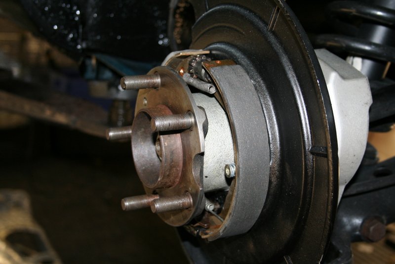

Adjusting the cable is only for taking up slack caused by a stretched cable. It will only mean you have less clicks to apply the brake, it won't make the brake any better.
The handbrake is adjusted manually by a toothed wheel - see the picture below. This can be accessed by lining up the hole in the outer face of the brake disc and using a screwdriver to turn the wheel.
To adjust the handbrake first slacken off the cable. Turn the adjuster until the wheel is just locked, then slacken off enough turns so there is no binding when turning the wheel. Repeat on the other side then adjust the cable as required for the right feel at the lever.
Sometimes the mechanism seizes up. If you can't get the wheel to lock easily then strip down the mechanism, clean and use suitable grease.

My parking brakes grip quite fiercely as well. The above advice covers the bases well. I'll only add that frequent use of the p.brake helps keep it operational. I use mine whenever I get out of the car just out of habit.
Oh....one more thing.....
If you ever remove the rear brake discs make sure you orient the discs properly on reinstallation. You don't wanna to cover up the access hole to the adjuster. Take a good look next time you're in that area....you'll see what I mean. Ask me how I know
