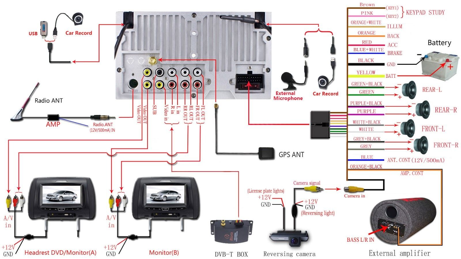

You would lose the clock for sure , the unit probably has a clock
looks like it has an external input jack
the head unit looks to power the speakers or a line to an external final amp for the jaguar premium stereo wiring layout
the DIN for X300 has been covered by others ,
