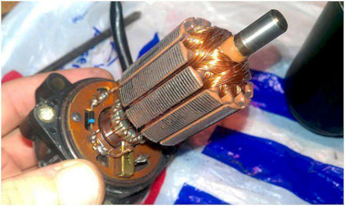

Cluster gauge and heating are separate issues. If your dash gauge temp shows low after 15 minutes of car running, you either have something wrong with the thermostat or the temp sensor died. Gauge runs of the sensor with a single wire at the front of the engine, near the thermostat housing. Check the wiring or swap the sensor, you can plug in an OBD scanner and check temp off the engine ecu sensor, this is the separate sensor and its next to gauge sensor, this one has two wires.
Your interior heating sounds like it will be down to auxiliary heating pump, this is on the left of the car hidden under intake elbow plastics, its plug is next to bulkhead so you can disconnect it, plug it directly to a battery and see if it makes any noises, if it doesn't - take it out and replace carbon brushes in it to fix it, or replace it with a new one.

The brushes are cheap and sourced from California as part # 33A
.15" x .15" x .35" BRUSH 33A (eurtonelectric.com)

Very common for the thermostat to stick open on these. Lots written here on lack of heating. Heater cores clog up and need to be backflushed, aux pump brushes wear out. Watervalve can fail closed. But by far, the most common is T=stat stuck open, then aux pump brushes worn out, then heater core clogged, then maybe WV failed.

This fluid is drawn by a dedicated electric heater pump that runs at all times with heat selected

The electric heater pump can be tested with a battery charger but put it on the lowest 2 amp setting

i had no heater when i got my car.
i replaced the thermostat - no bueno.
i replaced the brushes in the heater pump - BINGO!
both of those are cheap and relatively easy repairs.
there is plenty of info around in regard to the heater pump brushes change.
it is a relative simple fix, take out the pump, open it up remove the worn brushes, place and solder in new ones, put it together and off you go.

I took off the auxiliary pump, it was full of coolant,, The motor hummed when jump powered, I am getting 14.4 volts at the black plug (yellow nd black wires) with car running and warmed up.
I took apart the impeller and all looked good so I put it back together and put the pump back where it was.
The hoses around the pump got warm, but still no heat, and them the hoses seemed to go cold again.. Cabin still ice cold.
