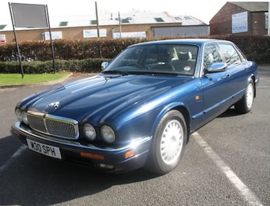

I live in the North-West of England with a wife and a 1995 XJ6 3.2 Auto (X300). Here's a recent picture if it helps identify my car.
