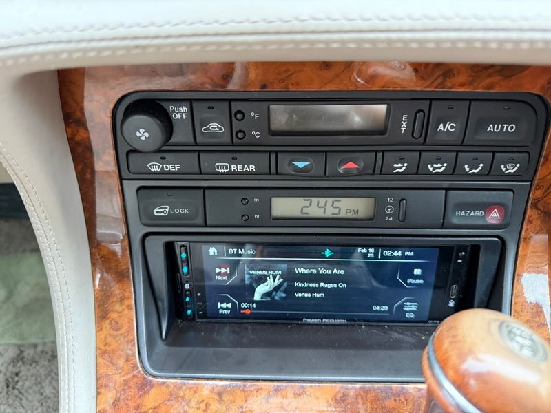

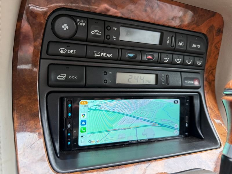

One guy has recommended it as nice and cost effective upgrade for older Harleys. So while i was looking for the original radio with fully working display i gave it a try.
Wireless Carplay/Android auto, BT, Radio, Front/Rear Aux, Internal GPS receiver (so no prob with location when your phone is somewhere deep) and two USB for play/update/charge. Looks pretty enough for me. I knew its integrated amp is pretty weak and will not bring proper power even to Rockford Fosgate 40W speakers I've installed before. So, I've found Clarion XC2410 amp pretty cheap on eBay. Idea was the head unit being shorter than original will let place the amp behind it and relatively low output power will not cause an amp overheat.
I've bought the 20-pin Multilok 070 male connector and made an adaptor from OEM harness to head unit and amp outputs. This allows me to rollback to OEM radio at any time (now i have one fully working and serviced but still keep it in dry clean place) should i decide. Power for amp was sent via 8GA wires from the distribution block under rear right seat.
Finally everything fits and looks pretty neat. GPS antenna went to the left corner under the windshield (it's the easiest and non-intrusive way to get its harness to unit and have a stable signal).
Bass anyway is weak. You can't have it a lot with just 6.5 regular speakers. I see an option to put slim subwoofer under the parcel shelf but still can't make myself to do a cut into it. So for now it is what it is. Probably in the future if i find the spare shelf.
Some cons are
- unit has internal microphone which is a joke so need any regular external mic usually come with aftermarket radios (like 5-10 dollars on amazon or ebay). It has a 3.5 jack on the rear for it. I also have an original Jaguar handsfree mic which I'm gonna try later and if it will work then put it on the overhead console OEM way.
- need some tunes on amp and eq to proper setup the gain level and frequency correction. Also need to set the iphone wifi connection with unit to full speed otherwise the audio quality will be low due to strong compression.
- volume control with small buttons needs to get used to as far as the small screen (but it has enough resolution to catch the information)
- main USB input (for music and updates) is rear and needs an extension to take it somewhere outside to have an access (i've put it into glovebox). Front is charging only.

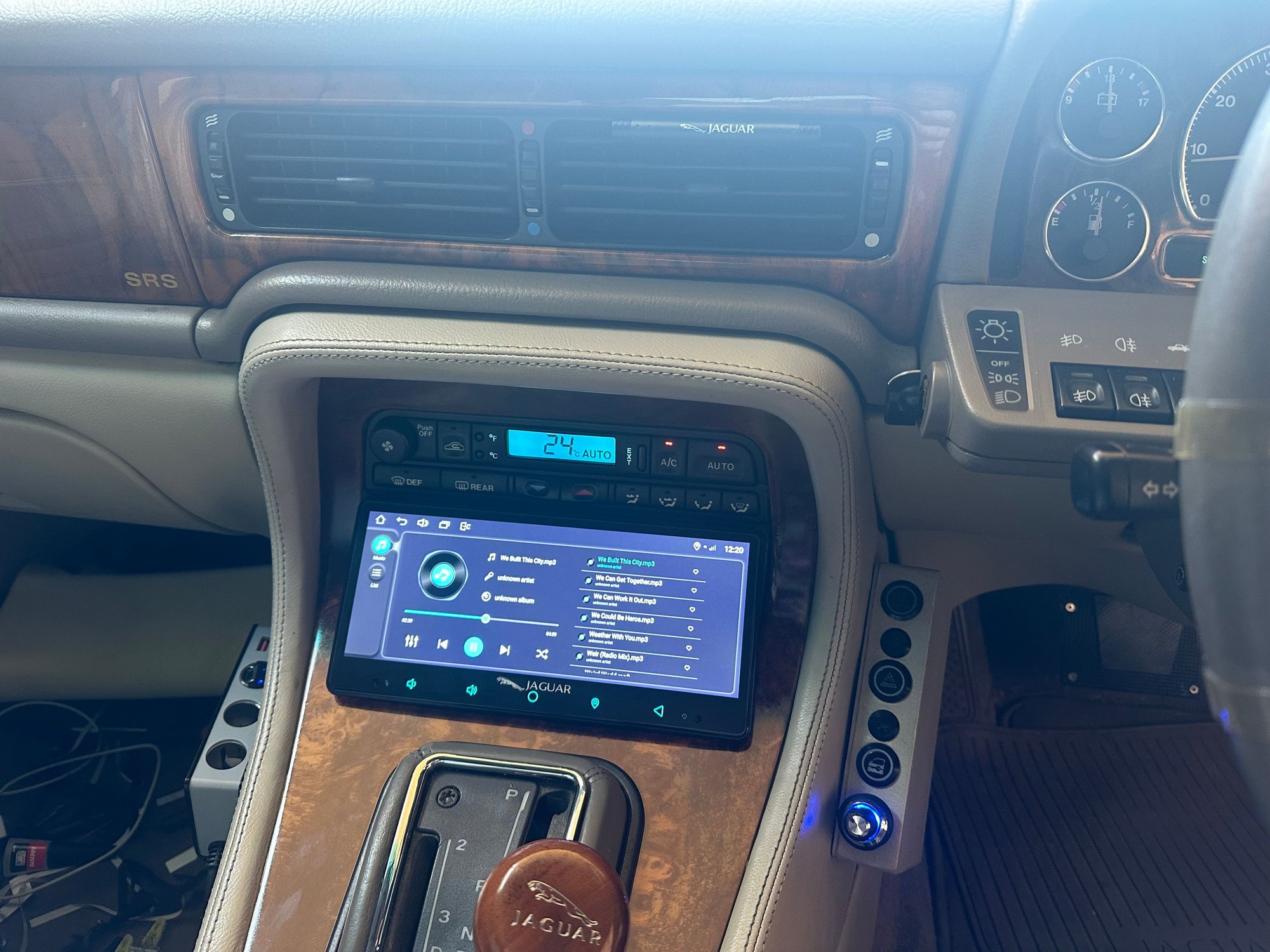

gotta be carful with any upgrades to android based units.
generally audio quality is very sub par.
and even when using the RCA outputs to an external amp it is still lackluster as they have very low voltage.
i purchased a joying system that had optical out to get around this shortcoming.
was a bunch of work to install as i moved the cloc unit out so had to rewire the hazard buttons and such elsewhere.
https://www.jaguarforums.com/forum/x...adunit-261554/

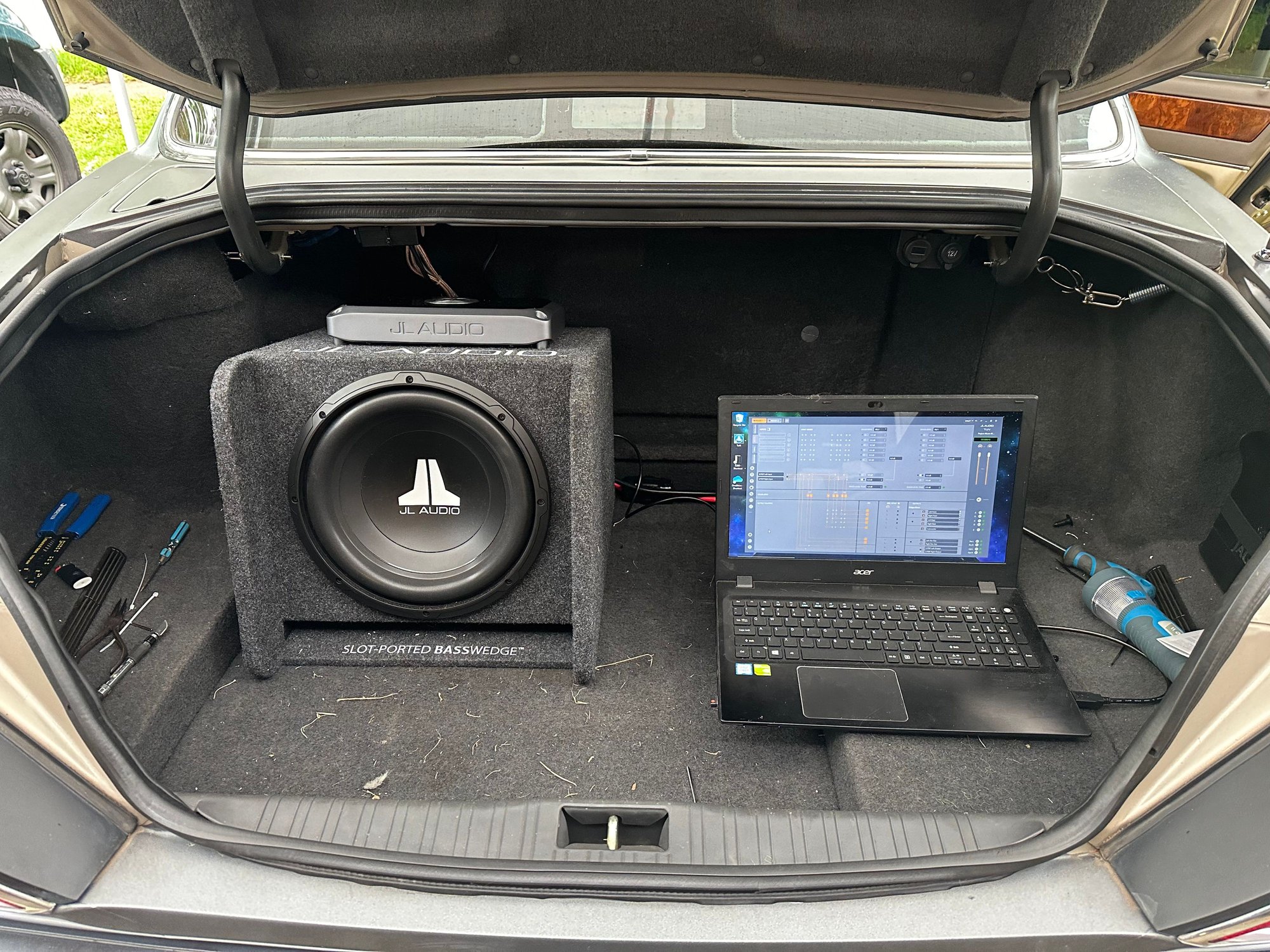

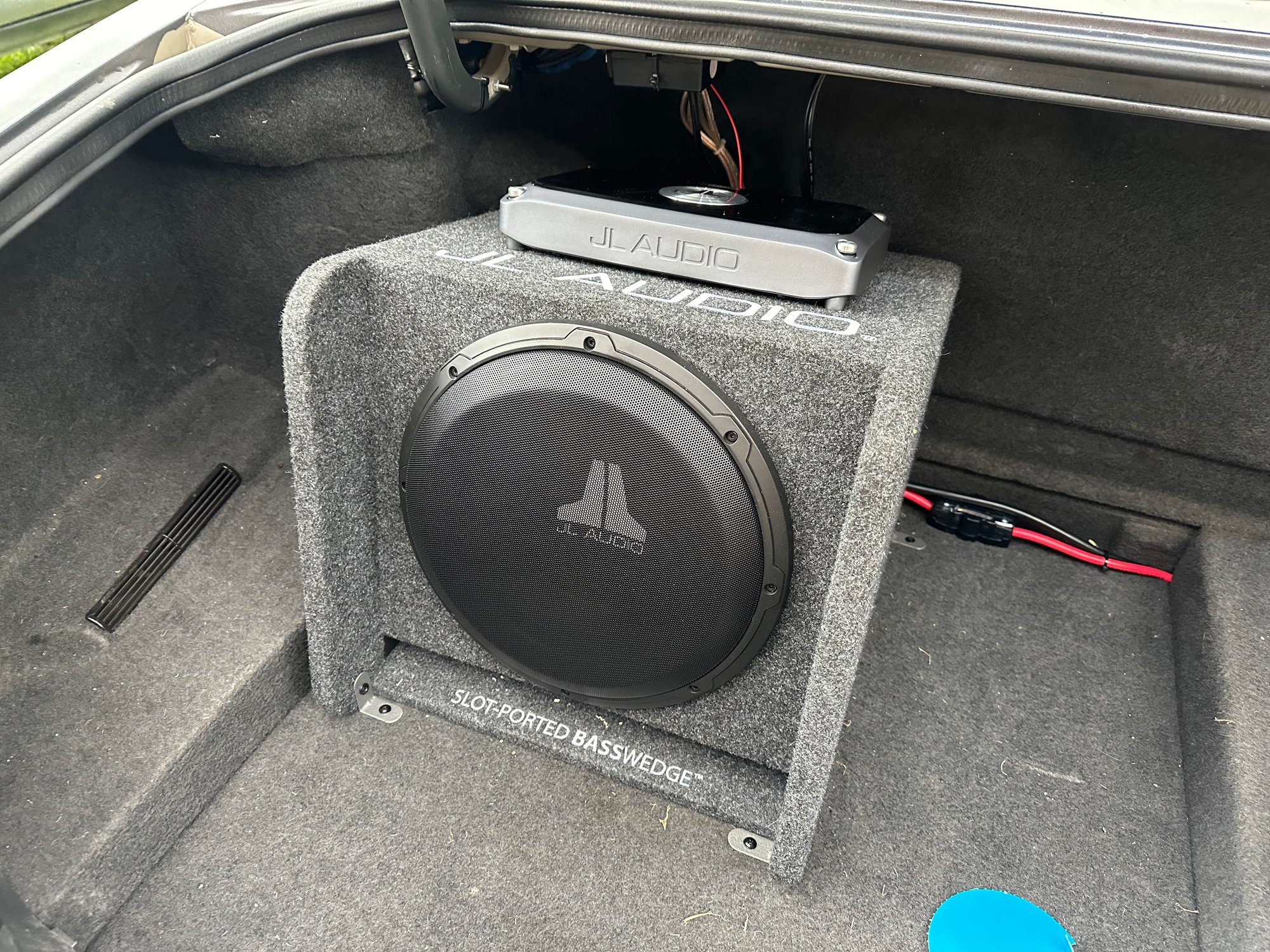

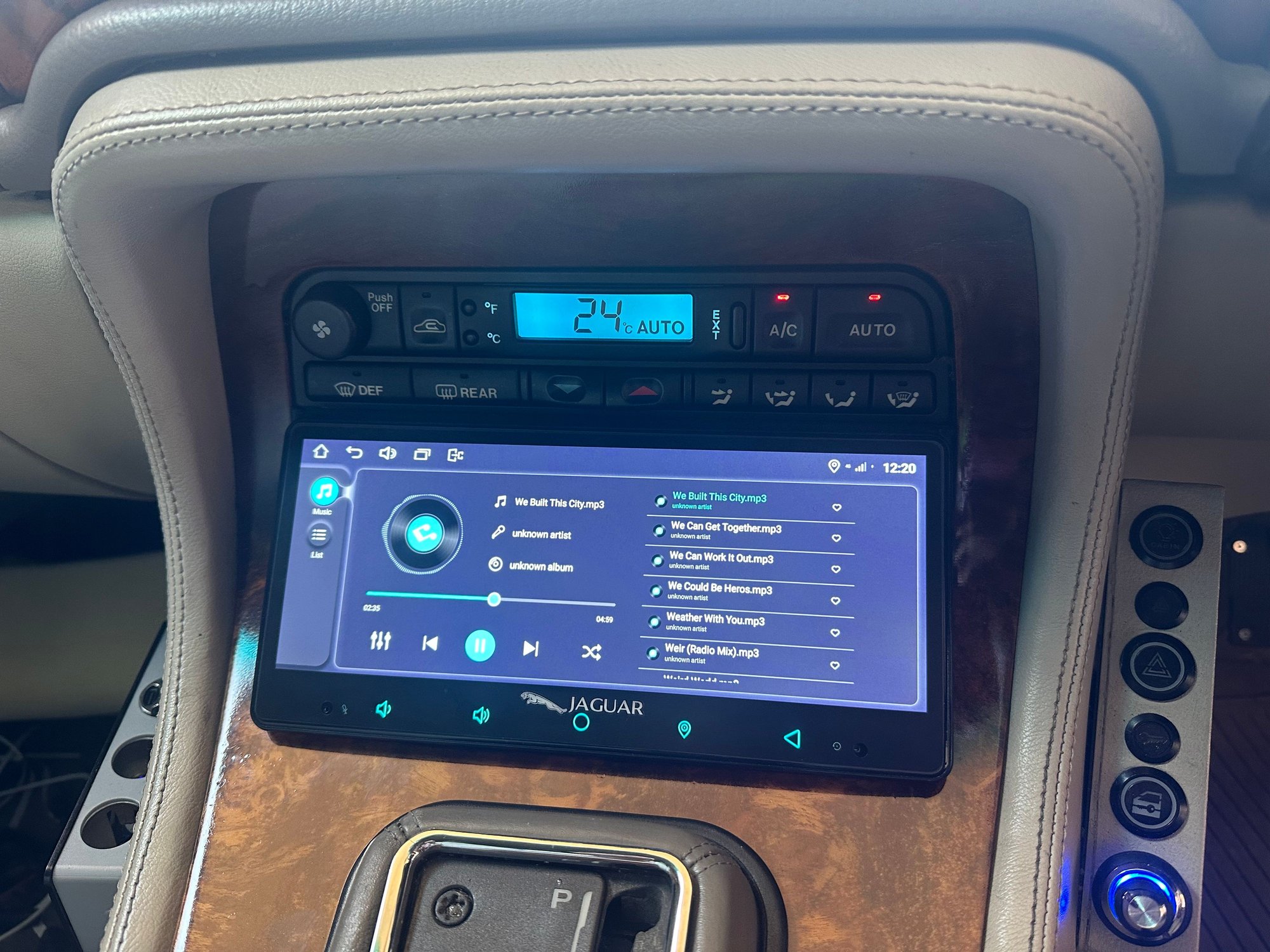

Just recently upgrade to a newer unit.
android 12
slimmer screen.
better resolution.
also connected it up to a high quality JL Audio amp, speakers and sub.

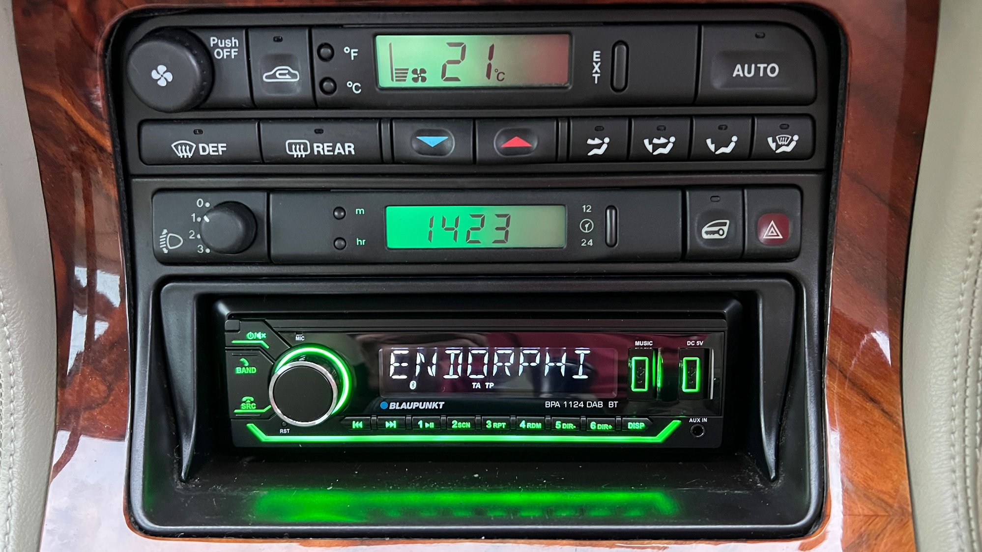

Old Nov 15, 2025 | 11:08 AM
JustSomeGuy's Avatar
Joined: Nov 2024
Posts: 49
Likes: 19
From: Whitby UK
Here’s what I settled on.
Old Nov 15, 2025 | 08:56 PM
Spud Maat's Avatar
Joined: Oct 2021
Posts: 1,389
Likes: 565
From: Sydney
very elegant looking solution.
much more simple and oem looking than mine.
