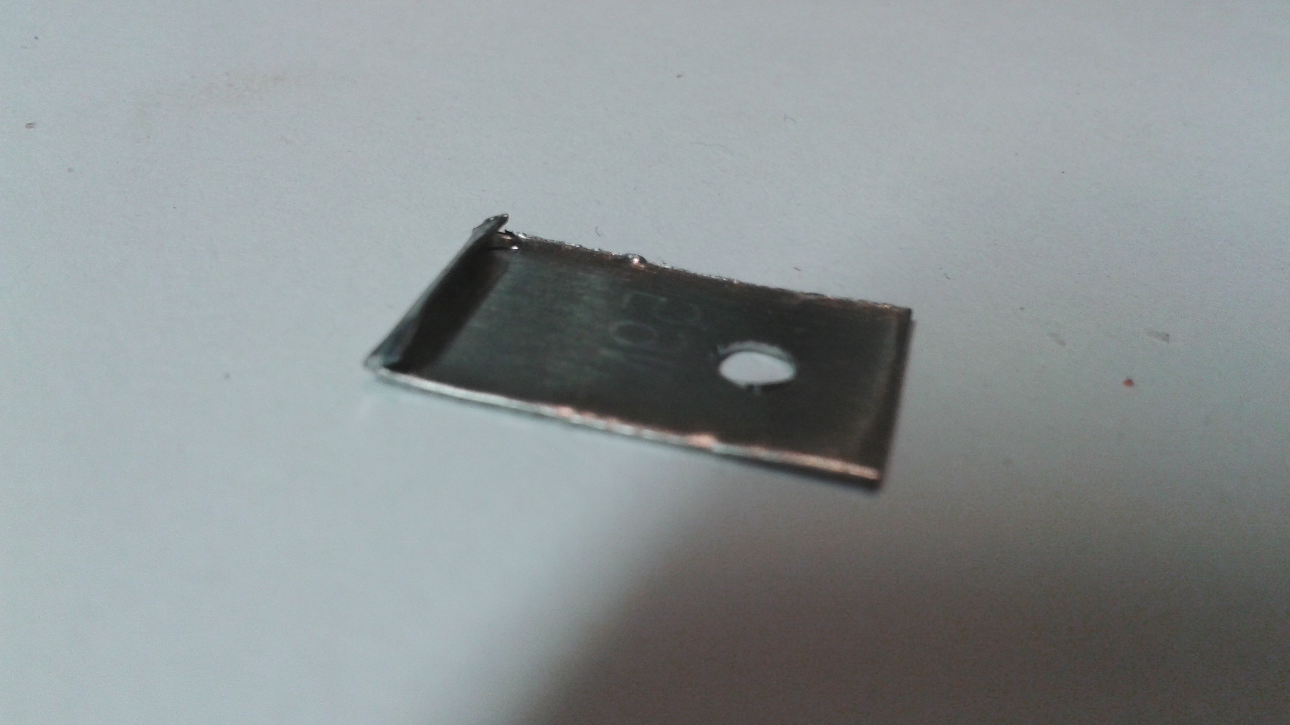

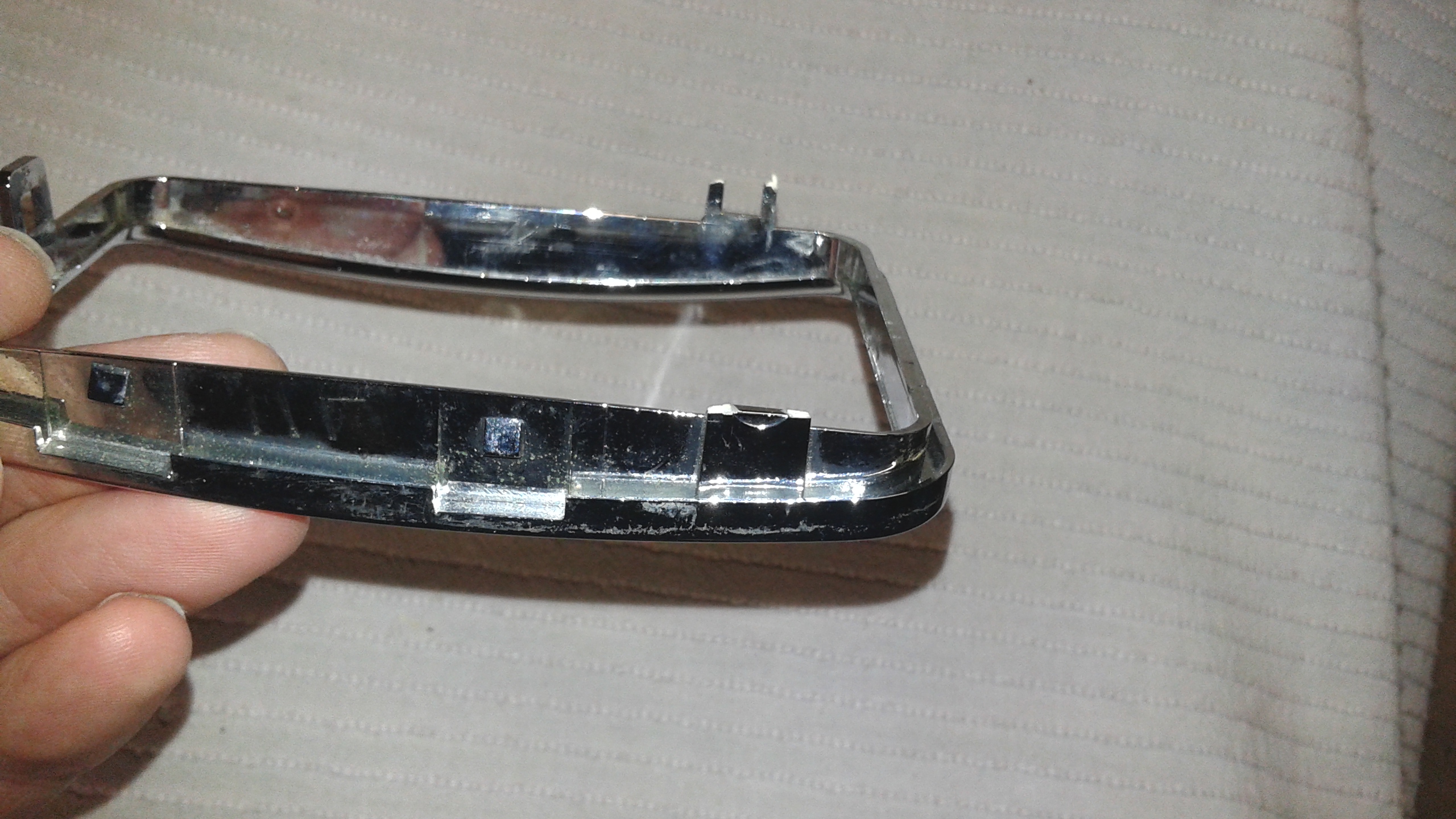

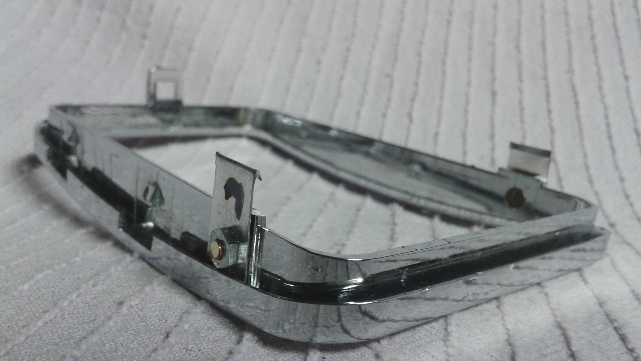

The J-gate trim comes loose because the pathetic retaining clips on the chrome part snap off. It appears that the clips, which are moulded into the lower edge of the chrome plated part, certainly weren't designed with any thought to the required strength and flexion.
My solution to the broken clips was to fabricate new ones out of a strip of light sheet steel (salvaged from the insides of a laptop i think) with the end bent over 135 deg. I attached these to the chrome trim with countersunk machine screws. I had to relieve the plastic moulding inside the leather covered part to clear the nuts, but you can't see that when its all assembled.
