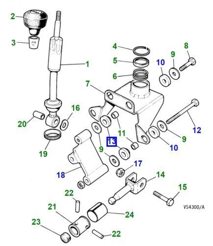

Here is a diagram of the manual gearbox linkages and bushings. Most of these items would have decomposed or broken causing difficulty in shifting. However, most factory parts are no longer available so your best chance is getting an aftermarket full set or a quick set from Simply Performance which also sells them on eBay.

Uses 8 bushes. I also used a TR7/TR8 kit but I replaced it with polyurethane bushes. The slop still exists...a lot less but such is the nature of the beast. Maybe try a firmer material (Al or Delrin?) but it's not really that bad tbh. You should replace the plastic white spherical bearing that houses the shifter itself too. It is the same as the BMW one (part number 25111469397 or 25111220600)
