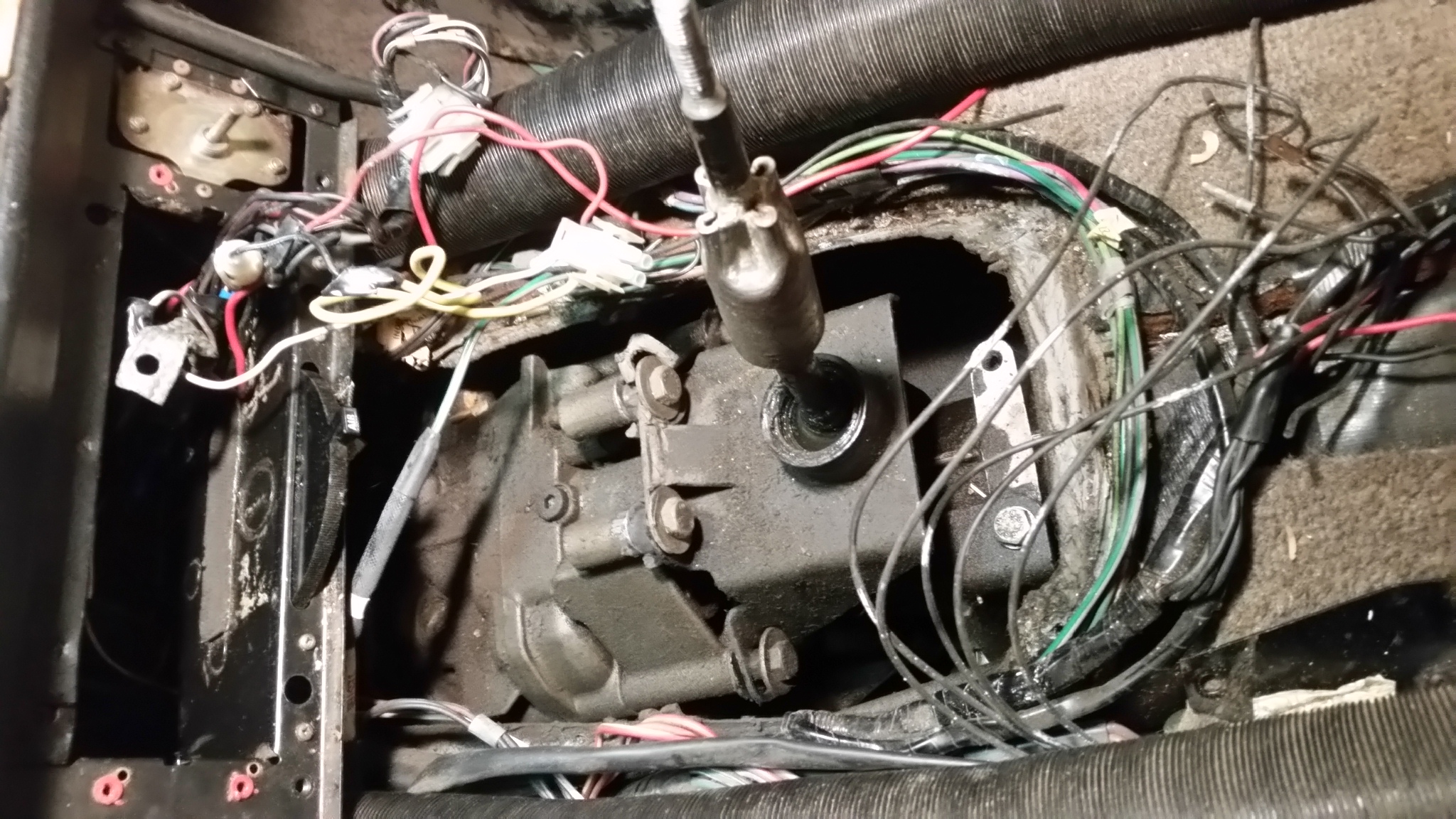

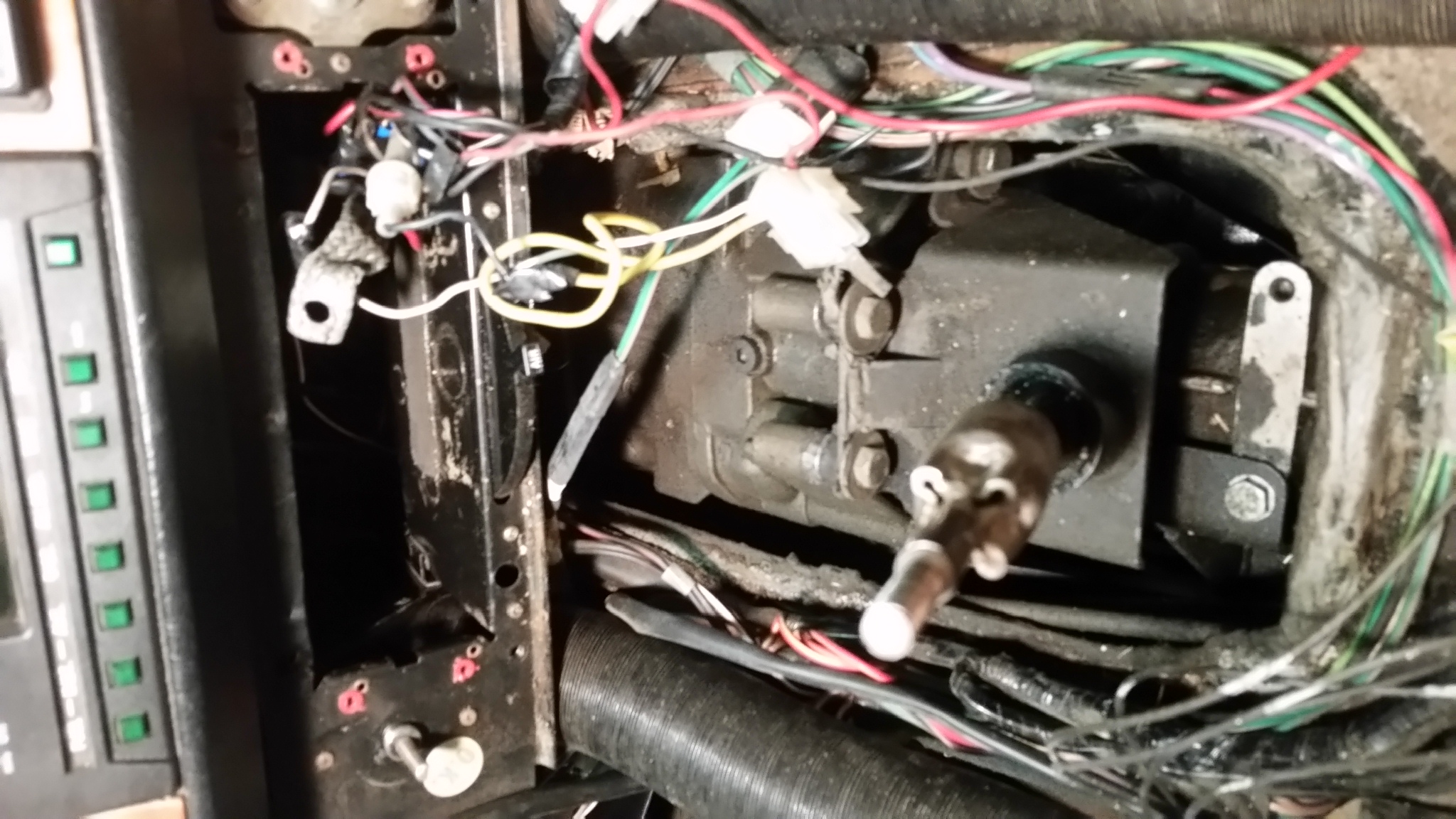

Hello,
linkage on my car is totally loose, the rubber washers (part UKC1090) that hold the plate are completely gone...
does anyone know if this black piece/cover can be removed so that I can get access to the bolts and plate(and the whole linkage)? There are two bolts on the sides with washers that appear to hold the cover, but I can't see what else is holding it.
Any other suggestions?
Thank you!

And the answer is... yes! This thing can be removed. It is held in place by 8 screws with washers and sealant. Screws in the back are difficult to reach, I loosened two of them, removed one, and one left as is, but was able to slide the cover out. Now I can fix the linkage! Can't wait to see how it shifts "in reality".
