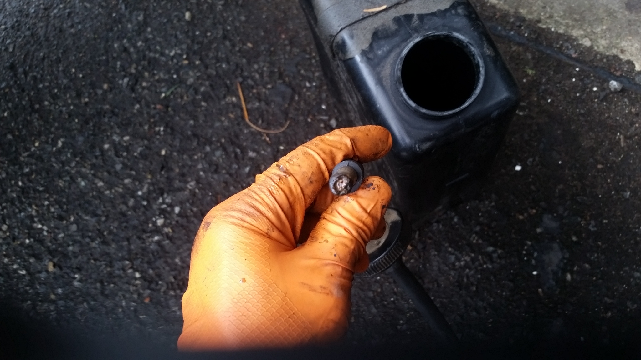

Cleaned hose that goes to overflow reservoir, yes - there is one behind left wheel.
This is how clogged connector looked like...
