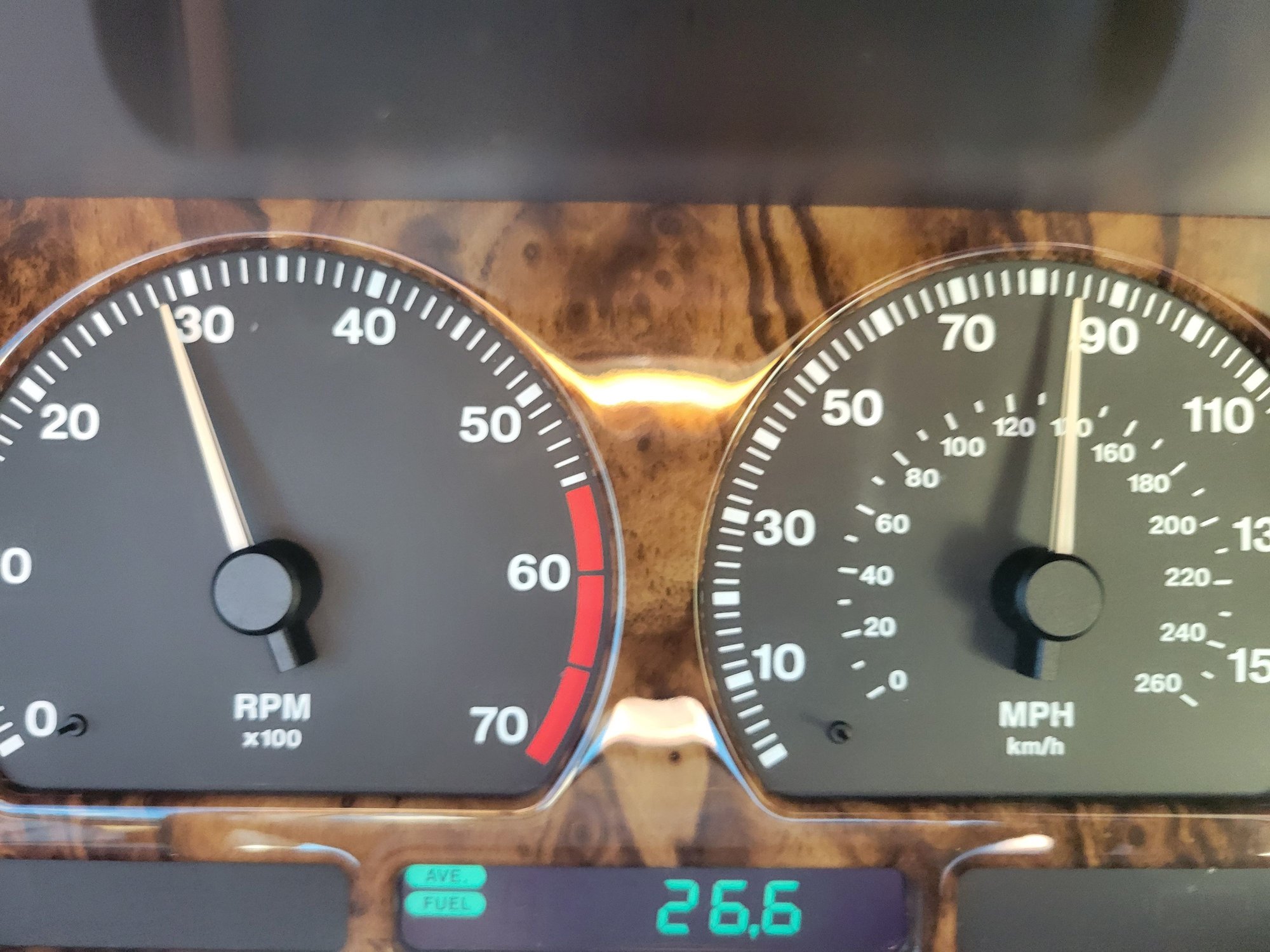

Today I drove 450 miles for an 2 hour meeting 225 miles each way and I was amazed at my gas mileage. I averaged about 81 MPH. I use to average about 23-24. However after cleaning the throttle body, speed sensors and making adjustments to my idle and such much better

Originally Posted by cdma
I tried it and power was the same and milage was worse.
Hi Phil,
One thing to be aware of is that the onboard computer only estimates fuel economy based on various sensor inputs, it doesn't actually measure fuel economy.
On my '93 XJ40, comparing the onboard computer with careful fuel usage tests over a 60-mile test circuit showed the computer typically reported 1 to 2 miles per gallon lower than actual measured mpg.
After installing the Andy bracket, the difference increased, so that while the actual measured fuel economy improved by about 2 mpg, the onboard computer reported usage that was up to 3 mpg less. I suspect the fuel usage algorithm cannot take into account the advanced ignition timing of the Andy bracket.
It would be interesting to hear Andy's take on this subject.

My take is that a accurate calculation would require a fuel flow meter with the available distance variable
In this case they are probably adding the pulse injector widths with a ideal injector flowrate and a ideal fuel pressure which does increase in pressure and flowrate with higher RPMs

Theoretically, all that would be required would be the odometer and fuel level sender signals. But obviously, the fuel level sender spends most of its time floating up and down when the car is in motion (thus the damper circuit for the gauge). Add to this the facts that the shape of the fuel tank and arc of the sender arm mean the sender reading versus fuel level is not exactly linear.

It would be linear with a short between sample time before and after which would be the case of a near instantaneous changing MPG reading
But then the slosh error which I don't think they can overcome even with averaging

Another variable to consider is the tyre profile as the speed/distance input comes from the LH rear wheel ABS sensor and does not account for tyre diameter/circumference.
