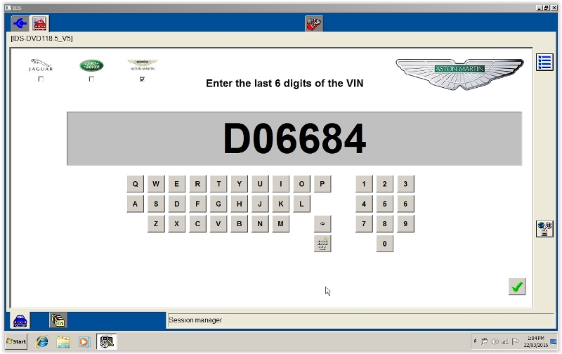

I tried a "new" install of IDS V118.5 on an old CF-18 Toughbook, just to see how it went (because to be honest, I was using V115 for old cars until now).
The CF-18 is running WinXP, it's an old laptop 10 years old or more now. Not an issue to install V118.5 and it works fine with a genuine VCM.
This is really the best option for anyone with a pre-2006MY car.
BUT it does need some "tweaking" still, unlike V115 which was a basic, offline program, V118.5 does try to go online so you need to disable a few things otherwise it will "time out".
Still much better than SDD...

Originally Posted by Engineer1
MAGIC!! Fantastic!! I have looked high and low for this information and could never find it! A synopsis like this doesn't exist anywhere! Thank you very putting this information in one place!
Well now it does.
Yesterday I ran version 118.5 with a Ford VCM and it worked with no issues. As you said, the first time I plugged it in and launched the software, it said I needed to update the VCM software. After a little bit, I was able to communicate with the vehicle.
Good. Not that it's surprising, the old IDS is really that simple.
In an earlier post, you said 118.5 needs some tweaking. What were you referring to?
Well... I did kind of answer this already, in the post you just quoted above.
