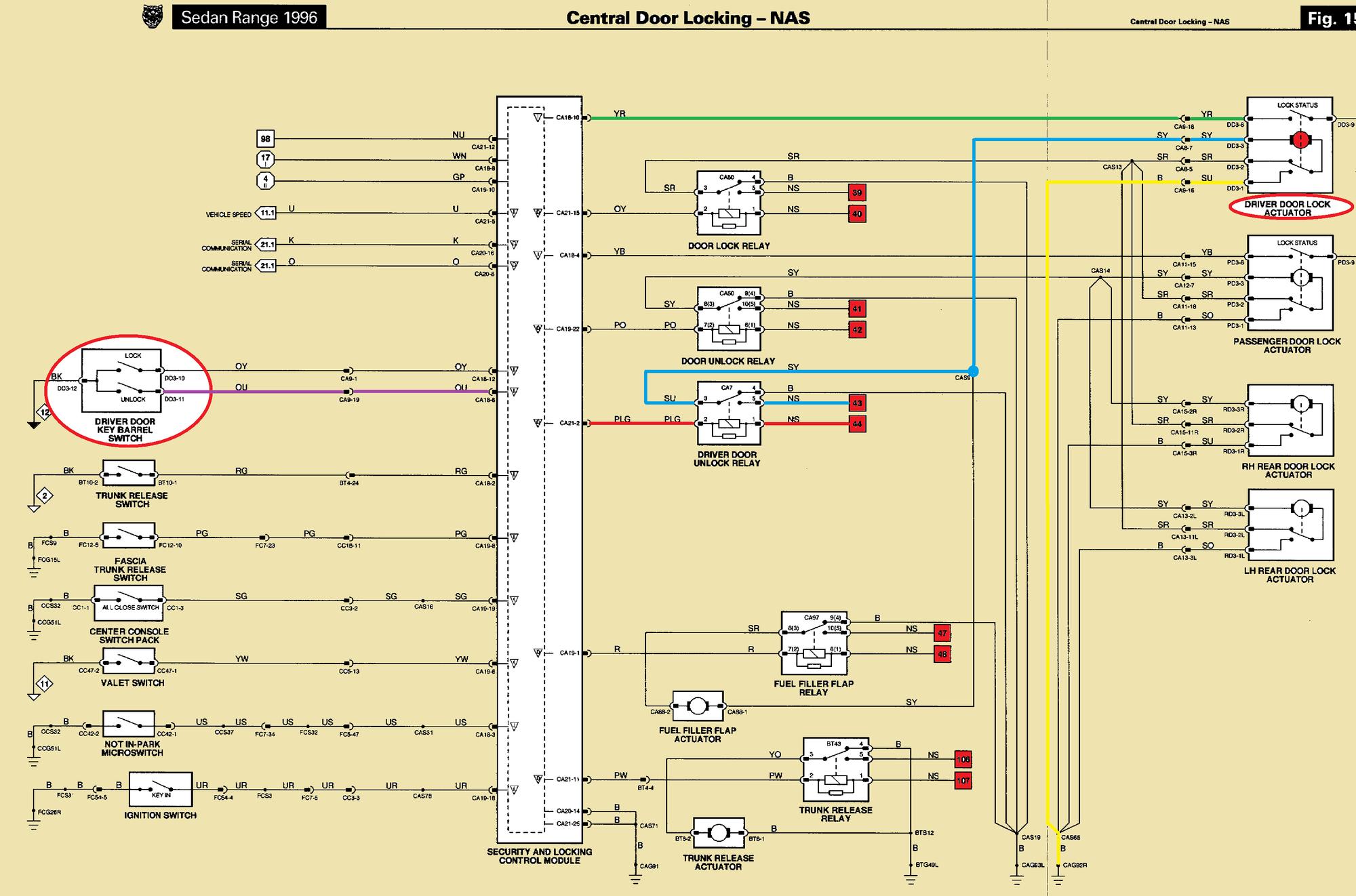

Huat as you can see from the diagrams the locking system is pretty complicated! From the video I can see that your locking pins are flush with the door panel when pressed in. USA models are longer which allows pulling up on the pins. Sometimes they can't be pulled up either. Here are probably the three most common failures in the alarm/locking/fob system:
The door lock peg will spring back up if the mechanism that locks the door is too tight (dirty) and/or stuck. The spring you press against is supposed to flip the mechanism to the locked position, but the mechanism won't move far enough to do so. The only real way to correct this is to remove the door latch and clean and lube the lock mechanism pivot points. It is necessary because one stuck lock causes confusion for the locking system and it will tend to leave all the doors unlocked. Most of the time the internal parts are not broken, but only stuck.
To program your fob, the trunk operation must be correct. Strange, but true. Step one is to open the trunk. If the trunk latch switch isn't working correctly the fob can't be programmed. Do the trunk lights come on when you open the trunk? That would be good, but you also need to have them shut off when you close the trunk. You will know because when closed the dash release button will work, and you will NOT have a trunk open indicator on the dash (with key on). You can hack this problem by manually connecting the wires of the trunk latch switch together (simulating a trunk open situation for fob programming).
And most importantly, the right side trunk hinge wires often get chafed or broken, causing all sorts of problems back there. So make sure those wires look ok. Remove a zip tie if need be and free them up to move along with the hinge. Repairs are often needed to those wires.

Old Apr 8, 2021 | 11:39 AM
