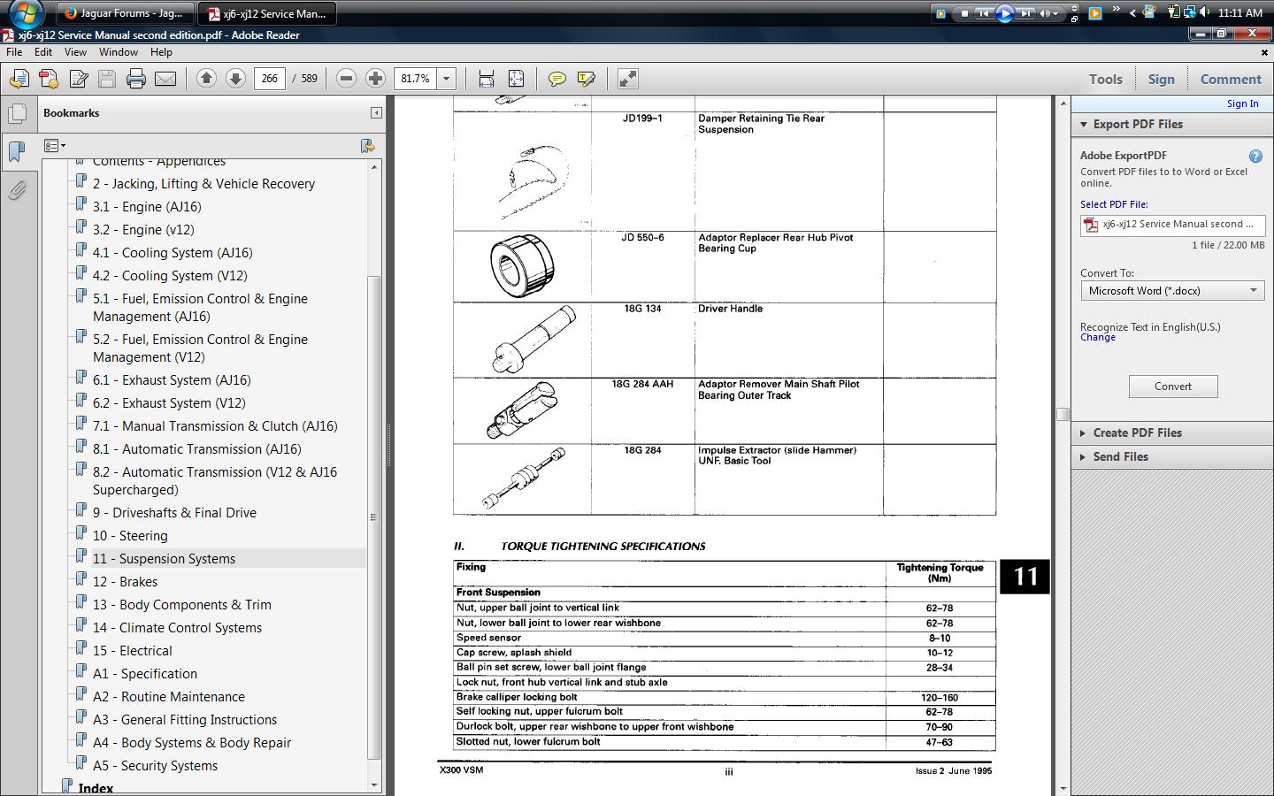

i did get the pdf but i can not find the names for the specs i want
can some one help me?
i attached 2 pics of the spec sheet from the pdf
Attached Thumbnails Looking For Torque Setting Please 96 VDP-spec-2.jpg   Looking For Torque Setting Please 96 VDP-spec-1.jpg

Translation:
Sway bar = stabilizer bar
Control Arm = wishbone
Shock absorber = Damper
You've got the right pages, you should be all set now that you know the names

Is this right
Sway Bar Bushing ( Need torque For 2 bolts on the bracket) 22-28Nm
Sway bar Links (Need Torque For top and bottom bolt) 52-64Nm
Upper Control Arm Bushing ( Steering Knuckle) 62-78Nm (Fulcrum Bolts)
Lower Control Arm Bushing (Steering Knuckle) 47-63nm (Fulcrum Bolts)
Front Shocks ( Need Torque for top Bolt And Bottom Bolts)
Top nut Shock Bushing 15.5-20.5 nm
Lower Shock Bushing Nut 48-60Nm
Then Im replacing the Upper And Lower Ball Joints
I Need The Torque for the lower ball joints 5 bolt On the bottom of it and the toque for the nut that goes on the ball joint
and for the top i need the 2 bolts toque that hold in it and the torque for the nut that goes on the ball joint
Old Jan 6, 2014 | 05:36 PM
AllanG's Avatar
Posts: 1,147
Likes: 372
From: Hickory, NC
Yes those are correct.
Ball joint nuts are the first two on the first page 62-78Nm
The lower ball joint set screws are 28-34Nm
The upper Durlock bolts are 70-90Nm
