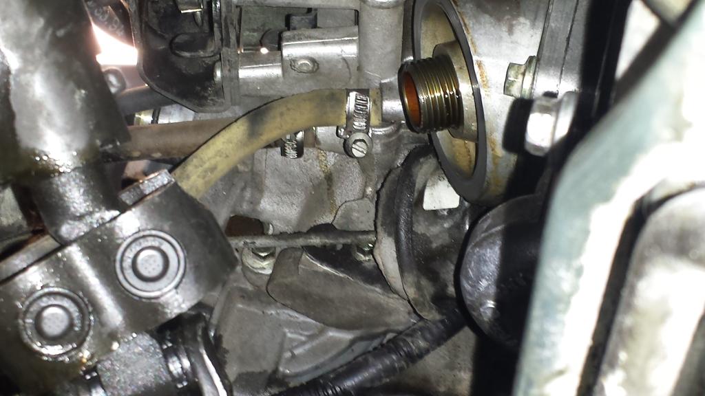

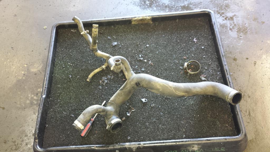

Hi everyone. I just joined up to share some info that others attempting this joyous task may find helpful.
Basically, you don't have to remove the supercharger at all to get this done. I did remove the housing/tube assemble between the supercharger and intercooler, which means i also removed the airbox and intake MAF sensor assembly. This allowed enough access to the parts of the hose that go to the expansion tank, and the two locations in front of that.
Because i am doing this at work, i was able to get the car up in the air and access underneath. I removed the sway bar, which allowed me to remove the alternator. This opened up all kinds of room to get at the hose from underneath and remove it after undoing the remaining hose clamps. Two of which (water pump and T/Stat housing (i think)) are loosened from above. I was basically able to remove the hose contraption from underneath.
Installation of the new hose assembly did require a second pair of hands to guide the hose up on the W/P and T/stat housing. Applying a thin coat of white grease to the inside of the hoses allowed them to basically slide right on. The second pair of hands was also helpful when it came to tightening up the new clamps.
Here's a couple of pics. I can post more later if desired.
