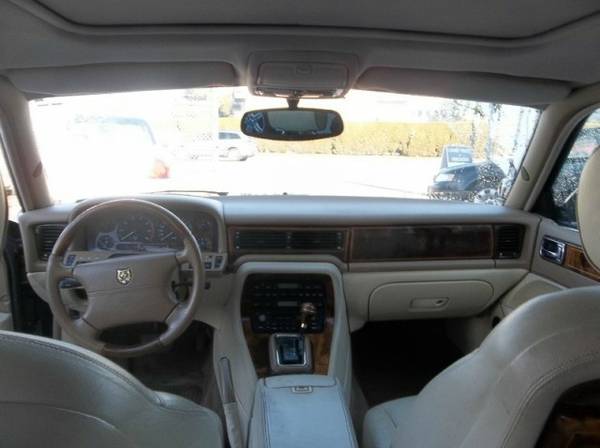

Some pics for enjoyment (the VDP, that is):
