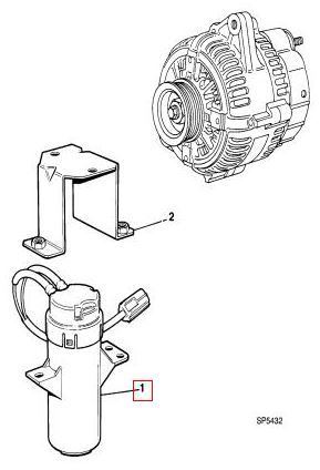

First, alternator whine can be a symptom of a failed diode, so it would be a good idea to have your alternator checked. But whine can also be caused by increased impedance in the alternator/battery circuit, and since corrosion on battery power and ground connections is a common issue on Jaguars, it would first be worth cleaning all the power connections between the battery and alternator, the engine ground strap, the battery terminals, and the negative battery cable ground point at the body.
The Alternator Suppressor Module is mounted in the LH side of the engine bay and is shown as Part 1 in the diagram below. The part number is LMB1820AA.
Here in the States, jaguarmerriamparts.com shows the module available for the astonishing "discounted" sum of $163.87, but I would be surprised if it contains anything more than an inexpensive capacitor/condensor. Maybe Ross can tell us. My guess is that it would probably be simple to replace its internals with less than $10.00 worth of parts from an electronics store.

Thanks Don. I will check the battery to alternator connections as best I can! The positive battery strap seems to be prone to corrosion and I haven't looked for a few months.

Just what does the "suppressor" do?

Hi Al,
This is really a question for Ross, but since he seems to have been especially busy lately I'll give you a layman's answer (which really more than I'm qualified to give).
Lots of components in a car can generate Radio Frequency Interference (RFI), a type of Electro-Magnetic Radiation (EMR) that can be picked up and amplified by a radio-audio system. Sources of RFI include electric motors, generators (the voltage-producing component of an alternator), and electric arcs such as those produced by spark plugs, switches, relays, etc.
Capacitors (formerly called "condensers") are devices with several unique qualities. They can store an electric charge, the amount of charge depending on their capacity (measured in Farads, or more commonly in consumer electronics, microfarads and even smaller divisions). Another unique property of capacitors is that they block the passage of direct current (DC) but allow the passage of alternating current (AC). And, their impedance to the passage of AC decreases with frequency, so to high-frequency AC like RFI a capacitor is as conductive as a straight piece of wire. (Impedance can be thought of as the AC equivalent of DC resistance, just more complex).
So, a capacitor can be connected between the alternator and ground/earth, and because of its high impedance to DC, it poses no risk of shorting the 13-14V DC produced at the regulated output of the alternator. But to the radio-frequency AC noise created by the alternator, the capacitor's very low impedance represents a virtual short to ground, preventing most of the noise from corrupting the car's electrical circuits and minimizing the amount of noise picked up by the radio.
There are other issues such as ripple currents, eddy currents, etc., as well as other means of filtering and blocking noise (inductors, resistors, diodes), but this gives you the basic idea.
When Ross checks in he can explain it better and correct all the things I've gotten wrong.
