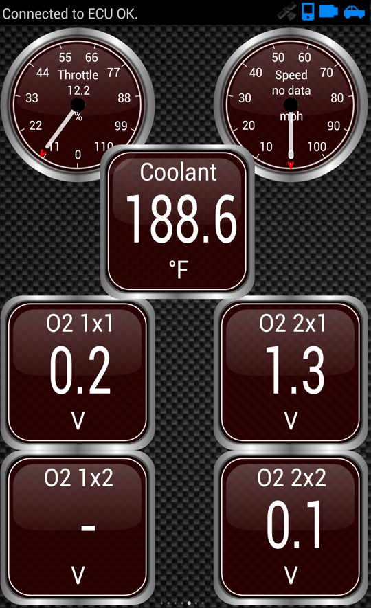

Here's a Torque screenshot. One of my sensors have no reading at all.
Can I guess that the bank 1 downstream sensor is dead and replacement is in order?

could be the Elm 327 adapter.....

Yeah, the scanner is simply showing no reading, which IS NOT what a result of bad sensor. Any codes?

Code 0138. This is the second adapter I've used.
