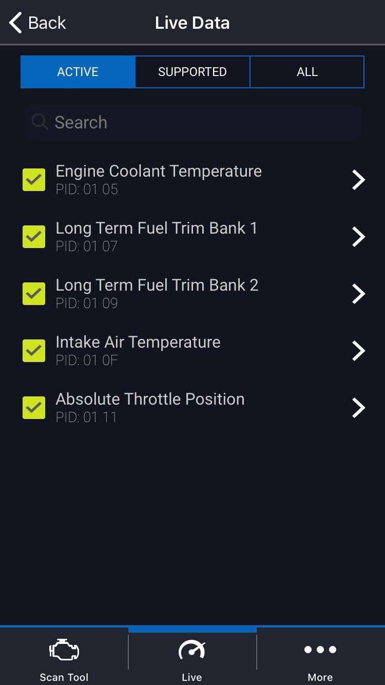

Also worth checking the fuel trims on both banks as that can point to which sensor is playing up.

Hi Cafcpete.
Thanks for your reply
How do I check the fuel trims?
Regards
Ian
Old Dec 31, 2019 | 11:15 AM
Cafcpete's Avatar
Joined: Nov 2018
Posts: 525
Likes: 334
From: London, England
You need an ODB scanner that can display live data. I use one called BlueDriver connected to my smartphone, but there are much cheaper ones around.
https://www.bluedriver.com
