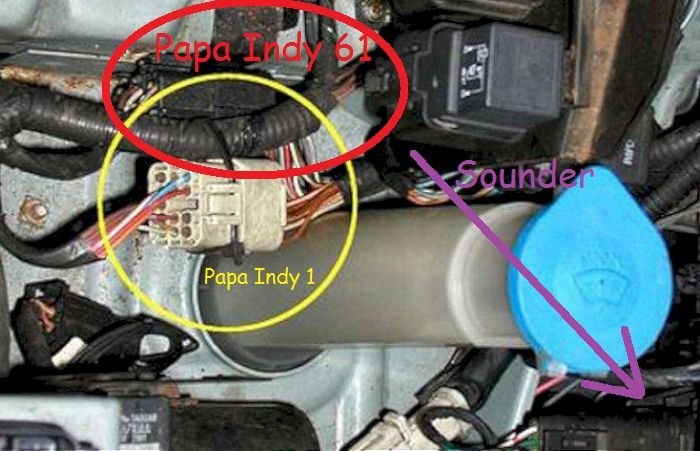

Clean the connector Papa Indy 61 pin 12 wire color White / Green
