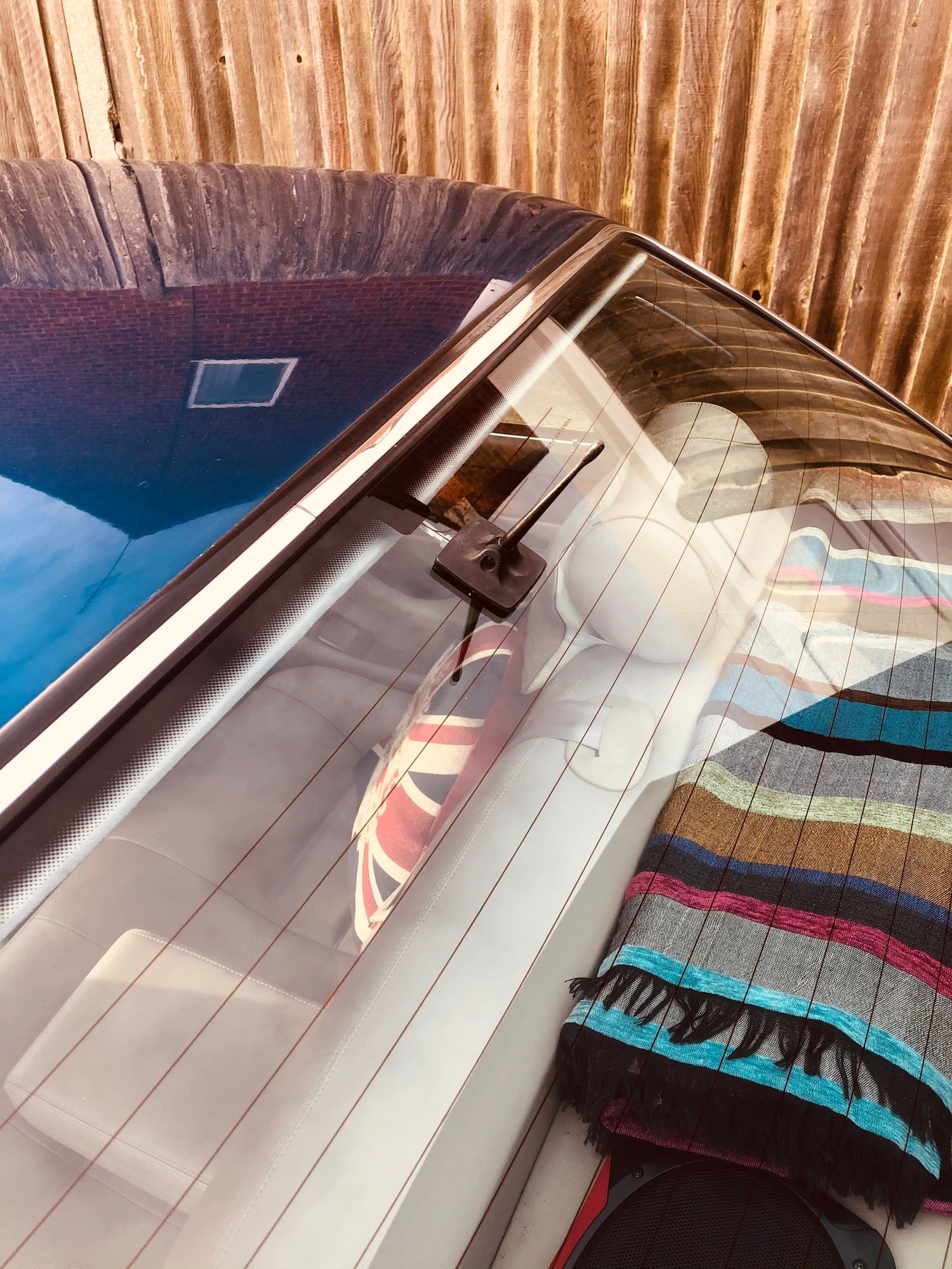

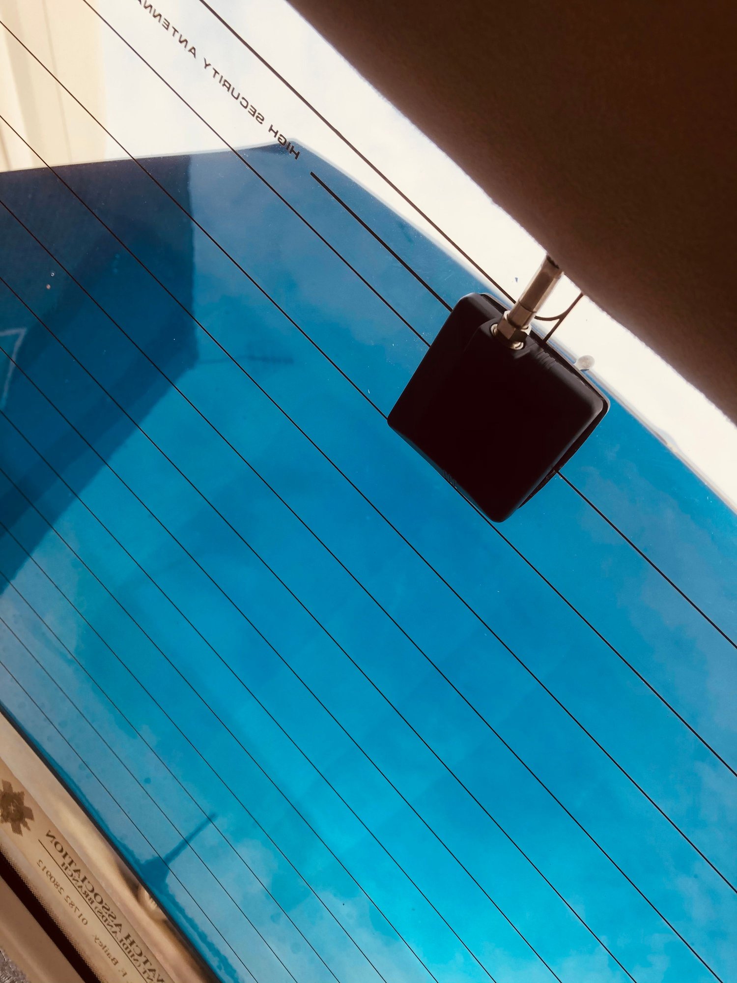

When I bought my car (1995 XJR) it had an original Jaguar option car phone. I have removed all of it, except the antenna, which is shown in the photo. As you can see, its on the rear window, rather than on the rear 1/4 light as you asked for in you initial post. I didn't take the antenna off, as at the time I wasn't sure if there was a hole in the glass, as far as I know, there isn't.
I've kept everything I removed, which includes: phone hand set, centre console lid with recess for phone (in black), sub-harness, phone module that fits in boot (under the parcel shelf).
I can take photos of all the above if you're interested.

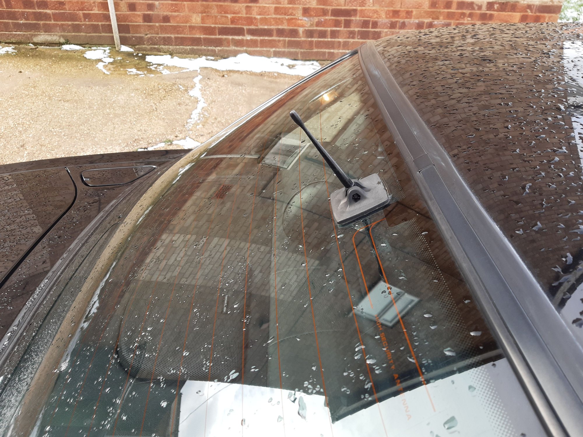

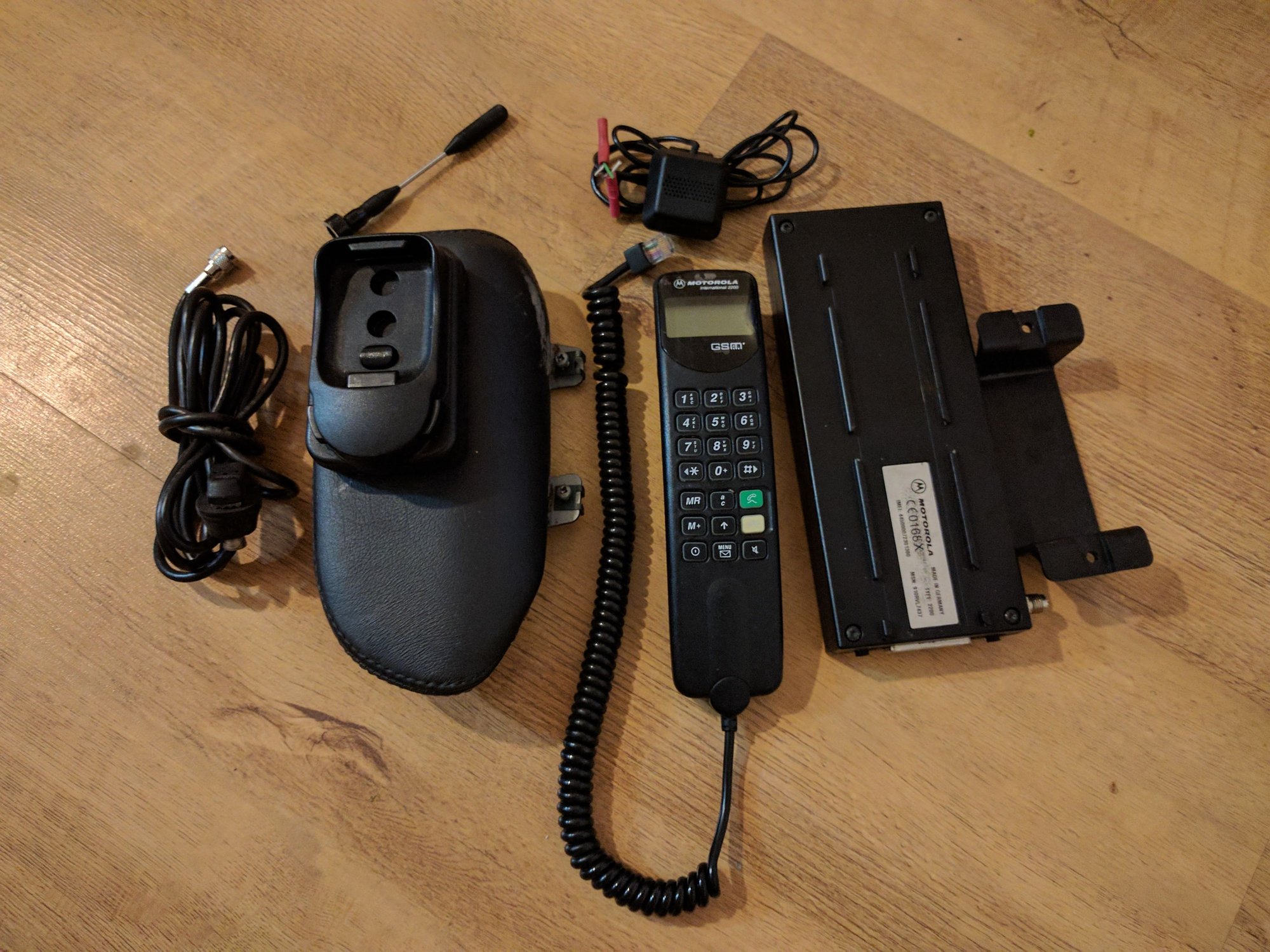

Antenna for the phone was originally mounted next to the fuel flap on the rear wing. Sold mine couple of years ago, fully working and of course the moment I did I wished I never sold it
This is on my old sport but had on my LWB too.
Phone worked no problems but not with all mobile providers, o2 definitely worked fine and I've used it for a few years. Handsfree too with factory radio. Mic was over the driver doors.

If memory serves correctly, "first generation" carphones had wing mounted antennae, but they migrated fairly quickly to through glass aerials like the one the Black Munk has shown. There is no hole in the glass, and once removed you can see that the on-glass transfer for the heated window etc has a space where the phone aerial is intended to be mounted. The on-glass transfer also has an aerial for the remote key fob.
I first owned my car when it was new, and the carphone aerial was the stubby one shown by the Black Munk. I removed it at the earliest opportunity, as it whistled annoyingly at motorway speed, but there is no doubt that it looked cool!

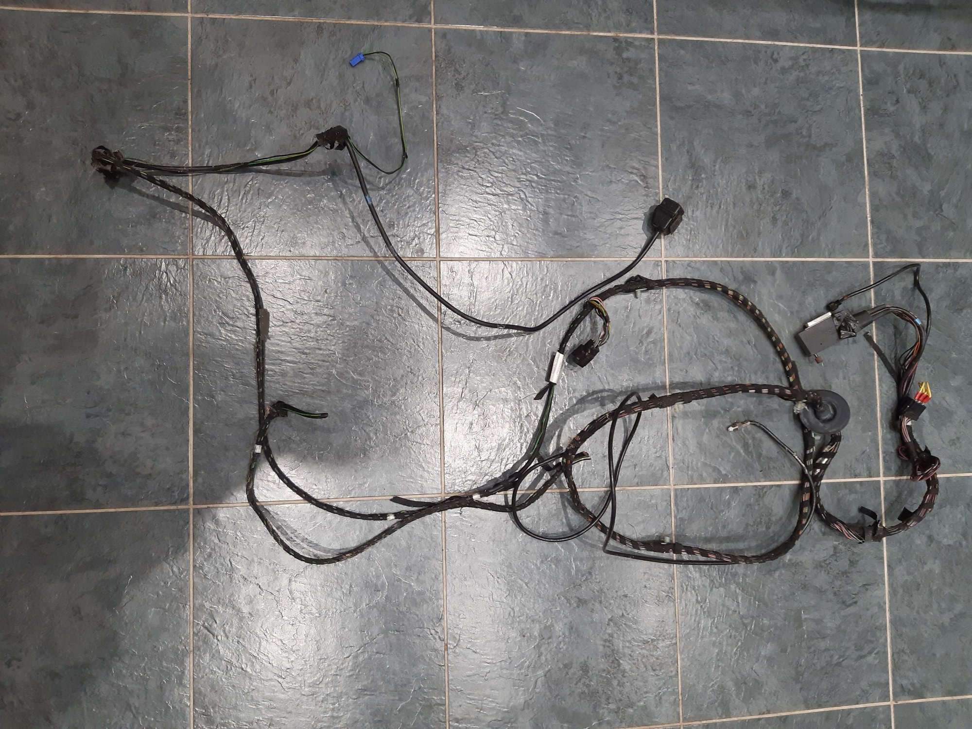

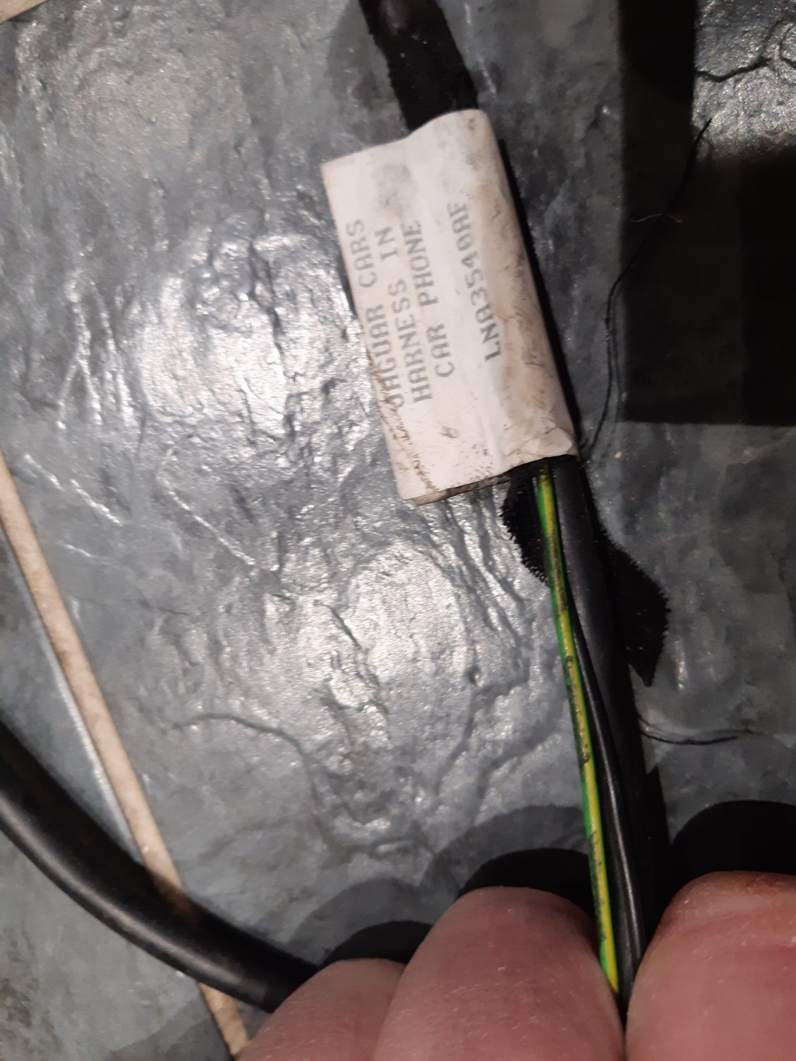

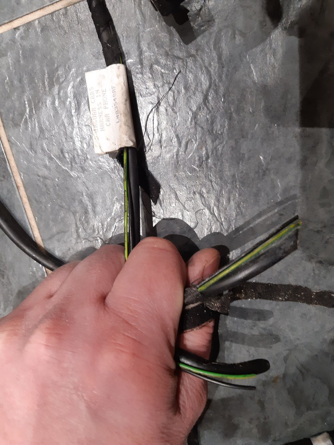

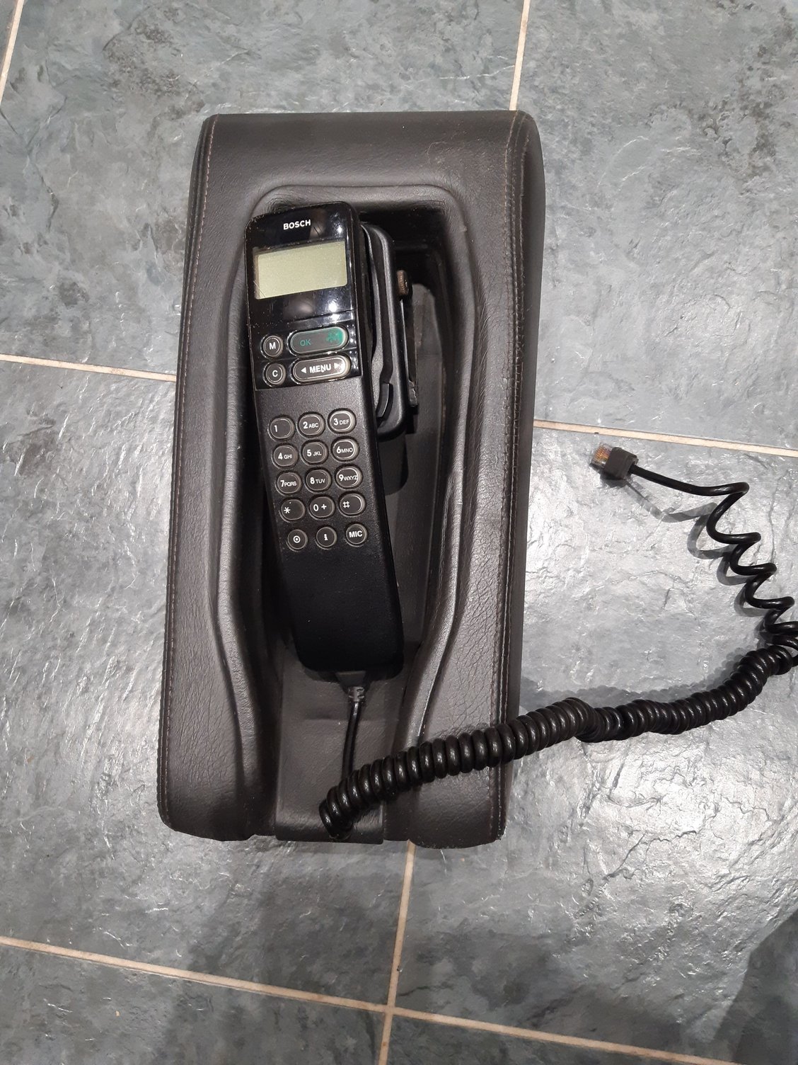

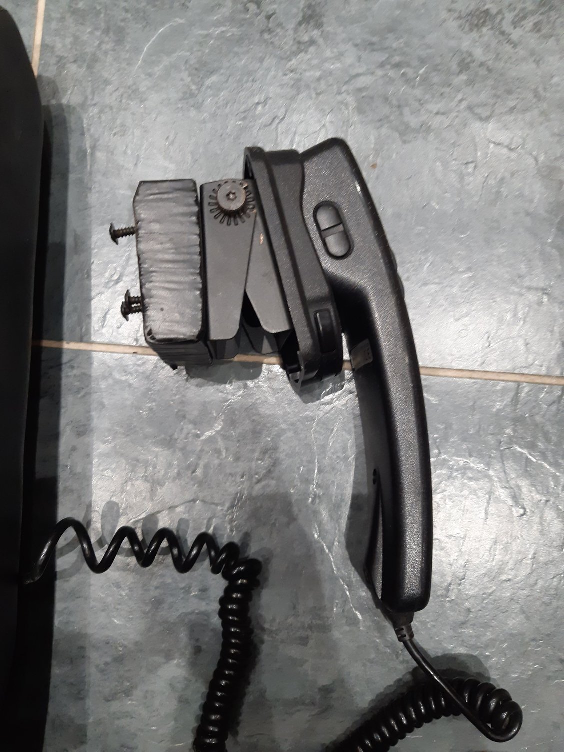

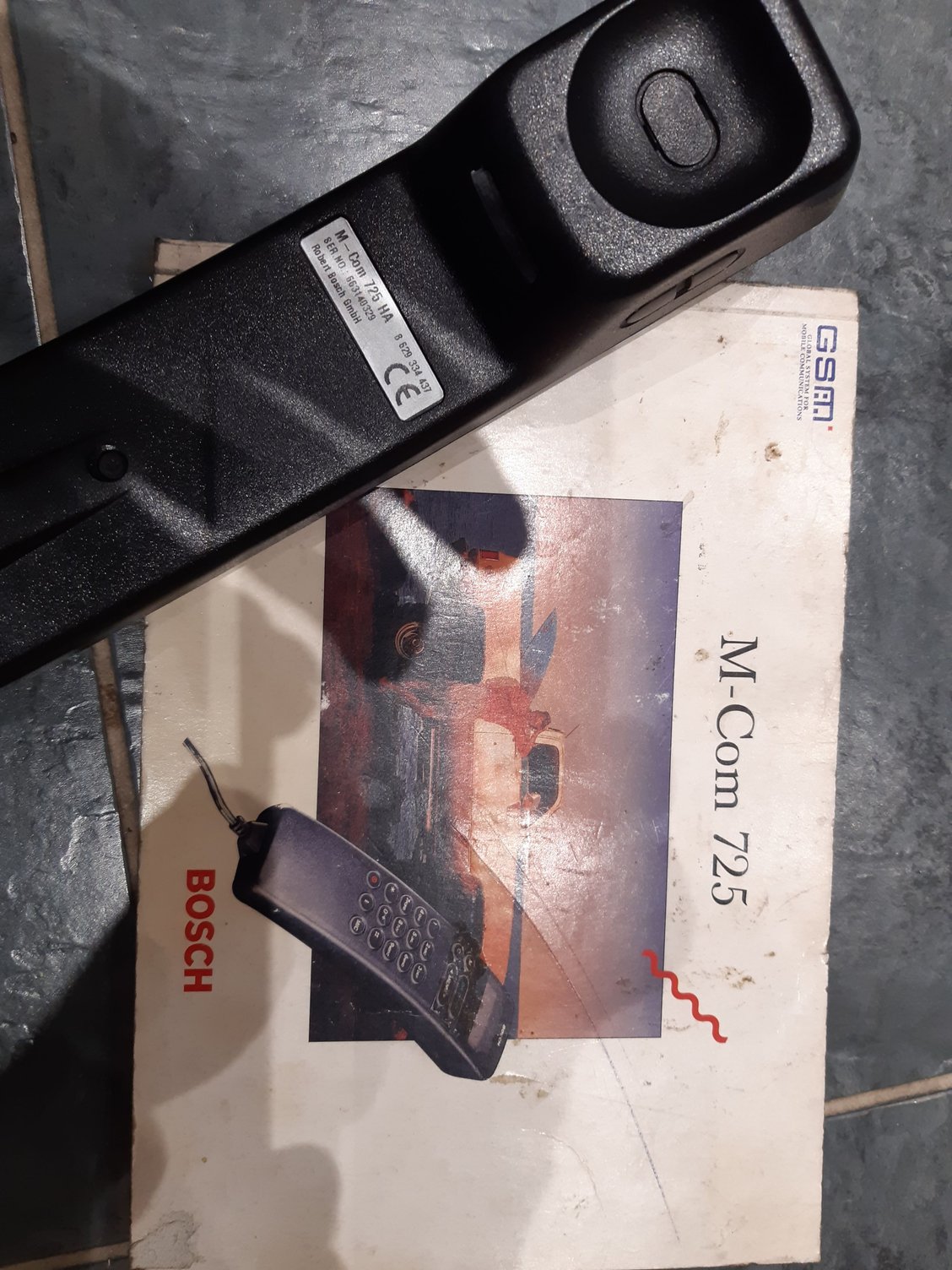

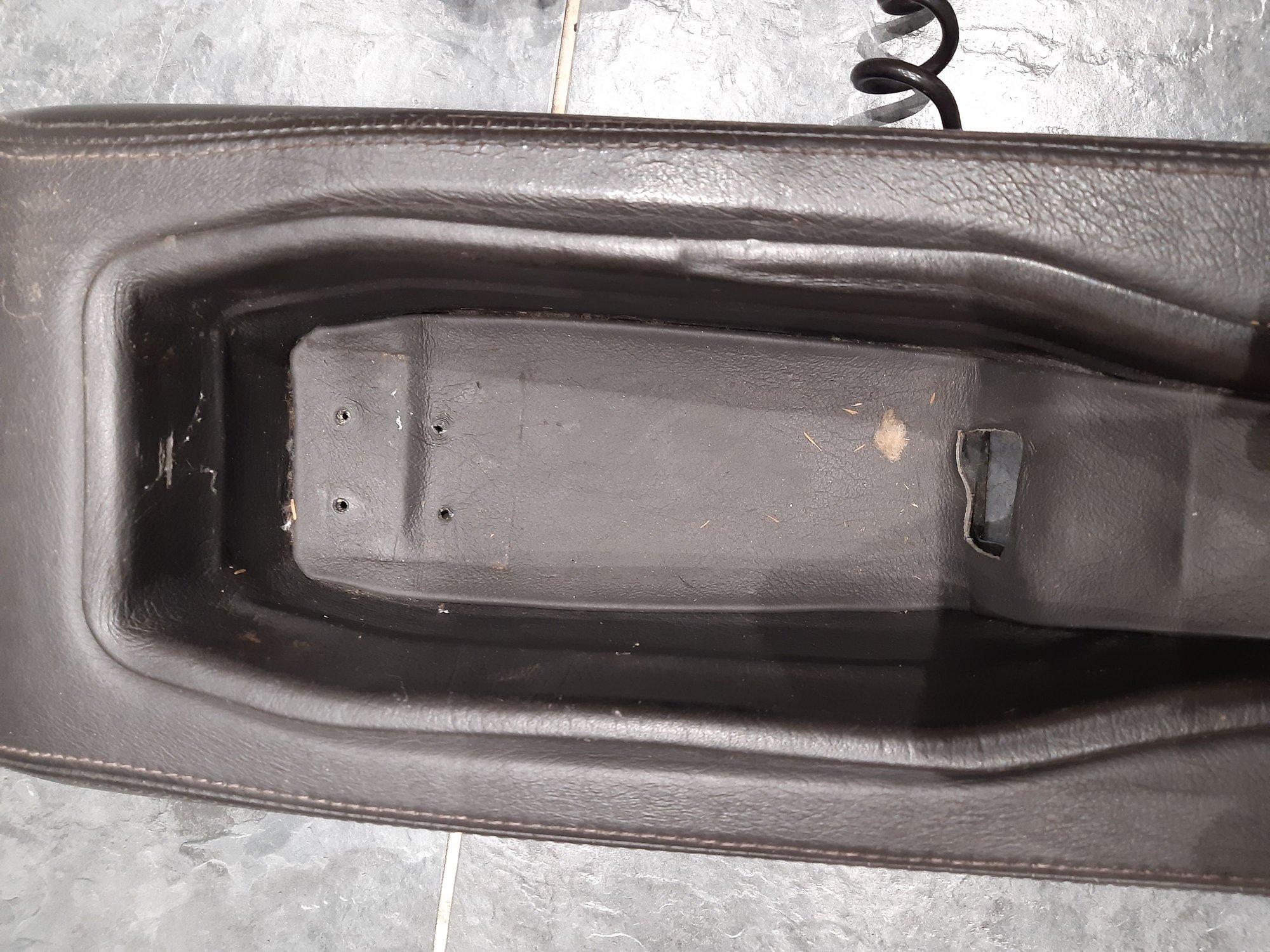

I should have checked before I sent the reply above... The phone module isn't with my other Jaguar parts, but I don't remember throwing it away, there are a couple of other places I can look. Also looking at the phone handset, it may well have been upgraded at some point, as it has what looks like a wooden spacer block wrapped in electrical tape. The harness is the Jaguar part, but I've cut it to get the last bit out from the centre console, it could be spliced together again. So in addition to the antenna, still on the car, this is what I have:
I've sent you a pm X300exec

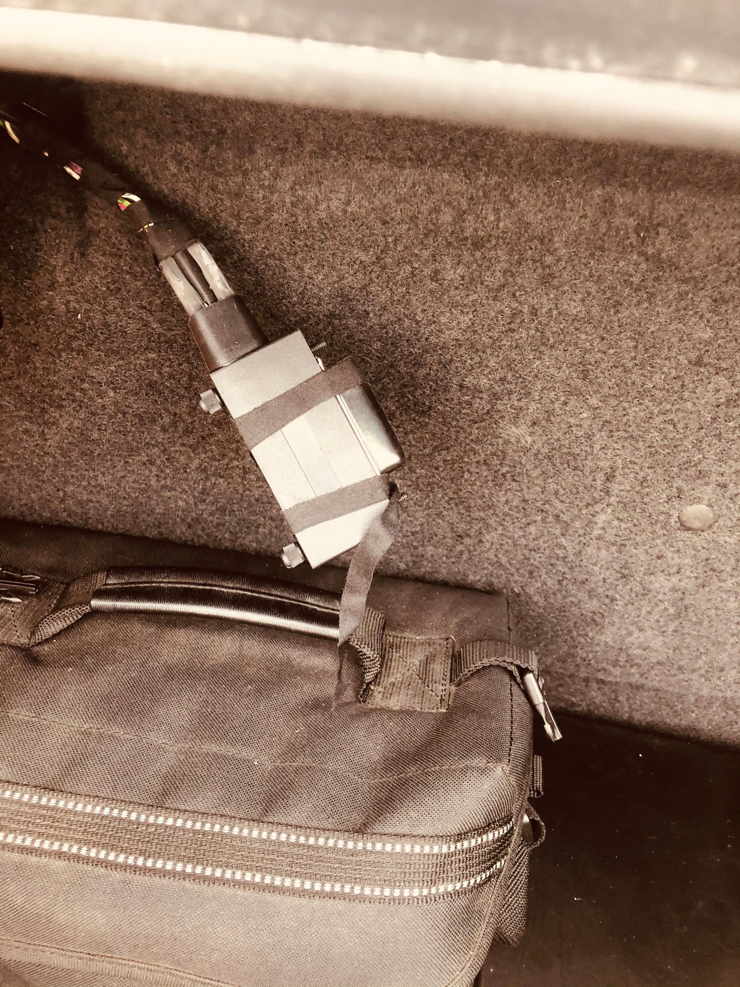

Thanks to all concerned !
ive now got a fully working car phone in my 90s yuppy mobile 🤣
wiring was all there just had to find it all and I’ve even found the correct module on eBay for a tenner to plug in the boot 😍
