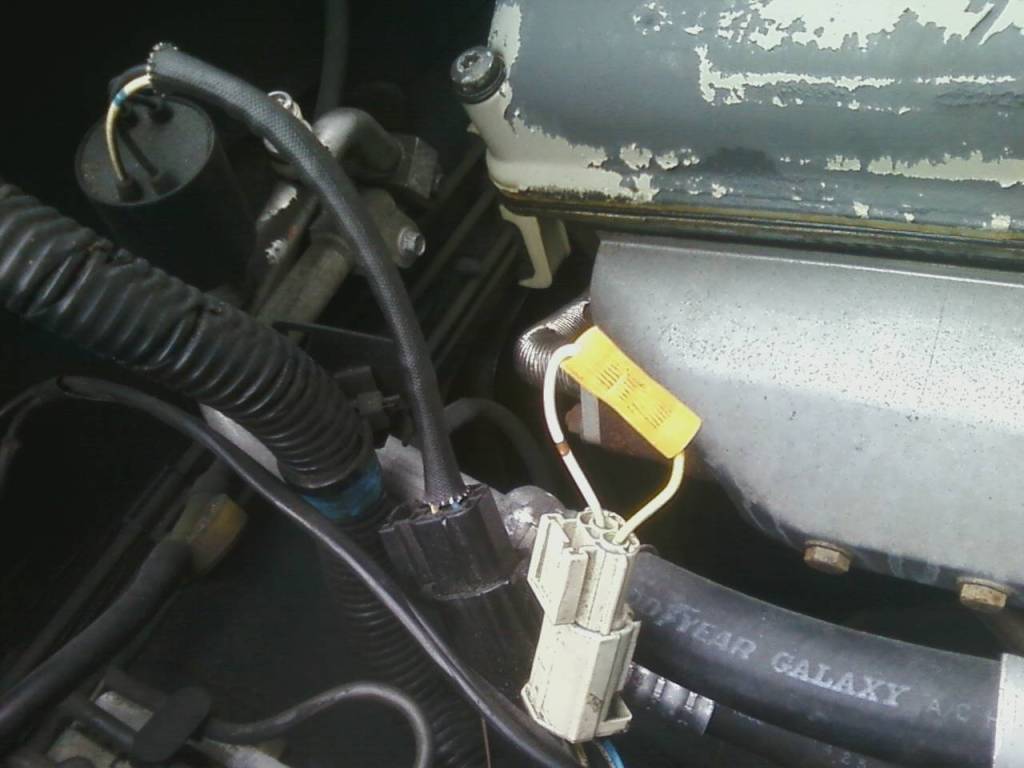

replaced the relay today with the new one mortorcartsltd sent me.
Still nothing.
Is the modification correct?
