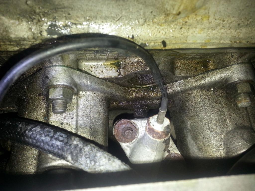

Ok the ring in the tank is there. I was looking for a white ring but it's black and it's not stuck. I just put almost a whole gallon of premixed coolant in the tank and then went for a test drive. When I got back I looked underneath and sure enough it's leaking. It's coming from somewhere near the top of the engine but I can't tell where. You can see that it sprayed the top of the valve cover and it's on the hood liner or whatever it's called.
I hate it when you fix something and something else just happens to break!!
Pics to follow.

Old Dec 8, 2013 | 10:10 PM
RiverDog's Avatar
Joined: May 2012
Posts: 47
From: St Augustine, FL
Attached Thumbnails Pls help: cooling fans not turning on and low coolant warning-20131208_222809a_zpsddb9a61f.jpg

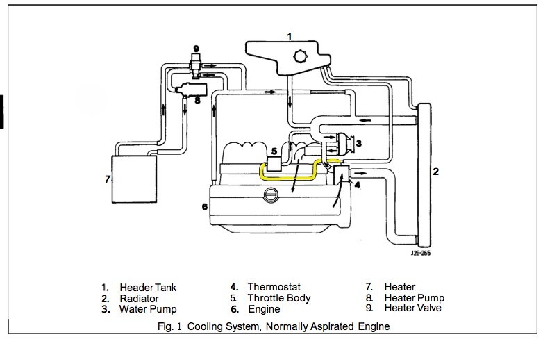

I'm thinking it may be leaking from this line (in yellow) but it's pretty hard to tell. Any other ideas?
Attached Thumbnails Pls help: cooling fans not turning on and low coolant warning-jagcoolingsys1_zpsb291d283.png
