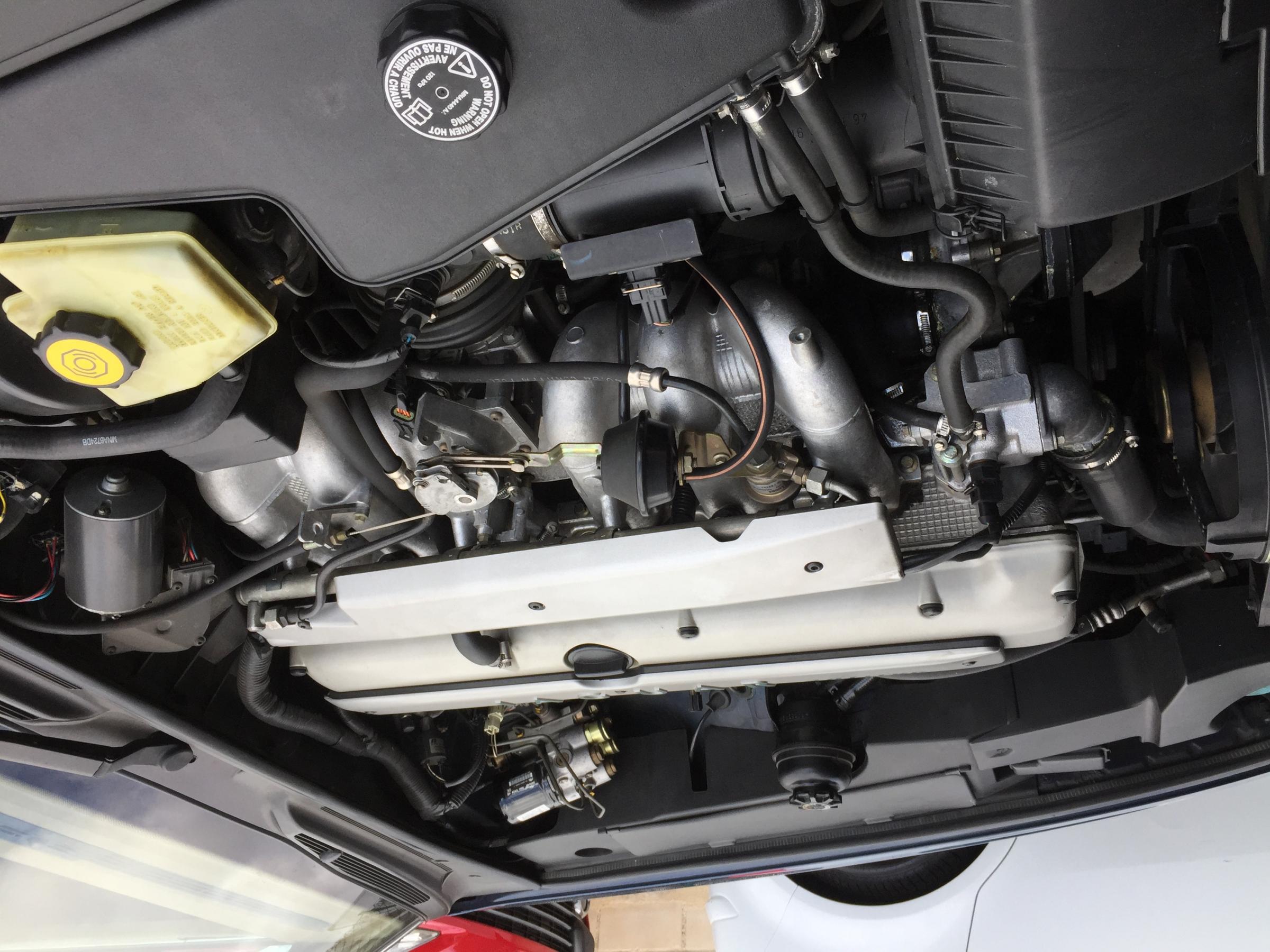

Hi there, I'm picking my "new" 20 years old X300 4.0 Sovereign tomorrow and have already booked an indy service to include:
- all fluids and filters including gearbox and diff oil
- new plugs
- OBD diagnosis just in case
I'm on a budget but is there anything else I should be checking as well?
Your expert advice will be highly appreciated.
I include a view to the engine bay, sorry is upside down for no good reason!

Congratulations on the pickup. Engine bay looks clean. Let's see some more pictures of that beauty!
I did everything you mentioned as well as replaced the wheel bearings. I replaced them because I wanted to start fresh. If they are still good I would just have them repacked with new grease. I also changed the thermostat, but that is mainly because I had to replace the radiator and decided to change the thermostat also.
Enjoy your new ride.

The thermostat is a good idea. They have a record of sticking open after a few years.
