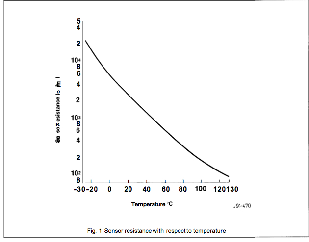

You probably know this already but the temp gauge readings displayed on the dashboard and the temp read by the ECM are measured by two different sensors.
So it is quite possible to have the gauge read normal because the temp sender is fine yet the engine thinks otherwise because of the ECT sensor being faulty. Measure the resistance of the sensor as the engine warms up. Here is a graph showing expected values.
If the values are correct, then I would suspect a wiring problem or connection issues at the ECM.
