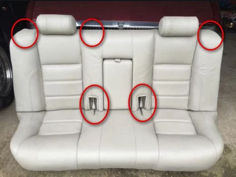

On early cars, the rear seat belts are mounted on the body C posts, with the centre belt being a 2 point lap belt. There are no holes in the top of the seat back.

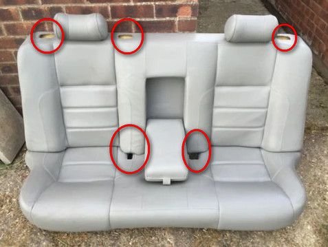

Later cars, the rear belts are mounted on the chassis behind the seat, and the centre belt is a 3 point belt. There are holes in the top of the seat back for the seat belt.

Early looks like this
Late looks like this
Note: If you have the late version, then I think XJ8 seats are also compatible..
