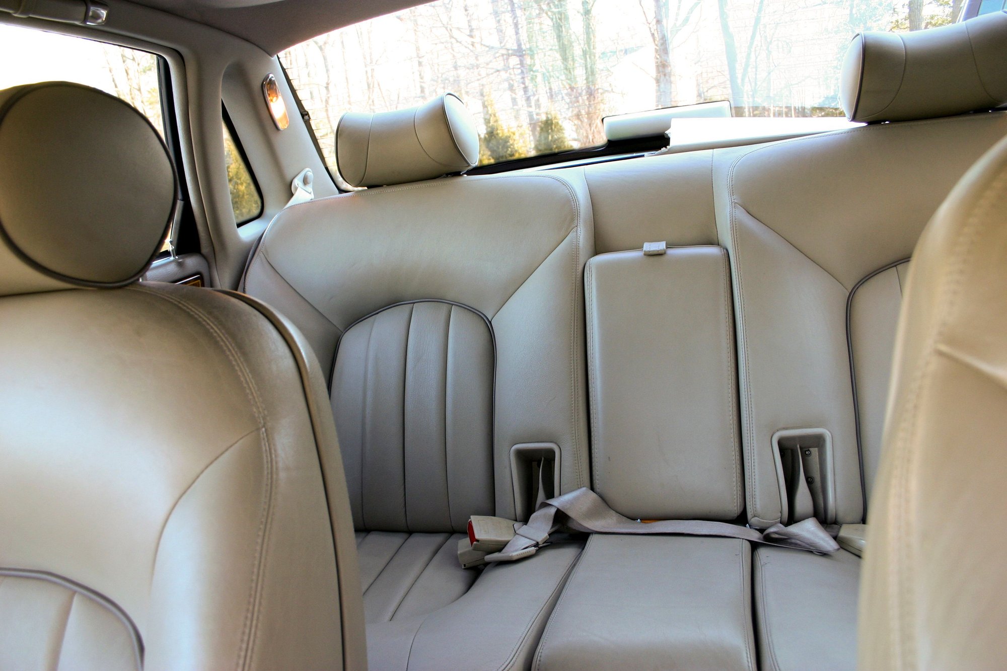

Im not sure this is what you need for the back seats, the last 6 of the vin number starts with 747 also that rear seat has like a console portion that lifts up in the middle where the 3 passenger would sit which i have not seen in other X300's i have been in.

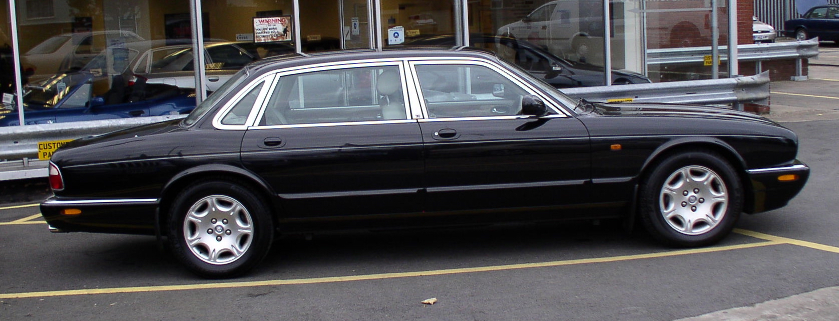

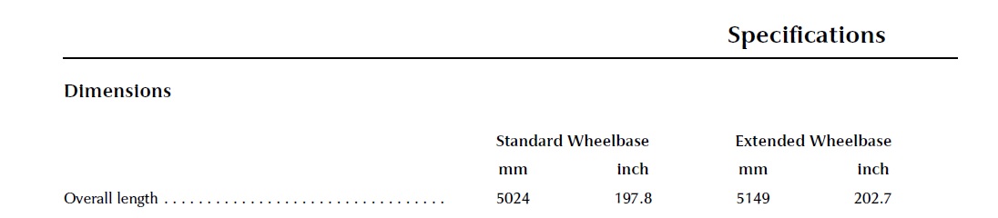

The LWB is 4.9 inches longer than the SWB. The extra length is all in the rear passenger compartment.
This is my X308 LWB but the side view is very similar to an X300. I had an X300 before this but haven't got an equivalent side photo!
Note the rear door (at the waistline stripe) of the LWB is very obviously longer than the front door.

It's not a good picture unfortunately, I should've said I would need the pic from outside with the rear door open, with the leg room. Then it will be obvious.

The little console extension is very common. It is in all models that have rear heated seats.

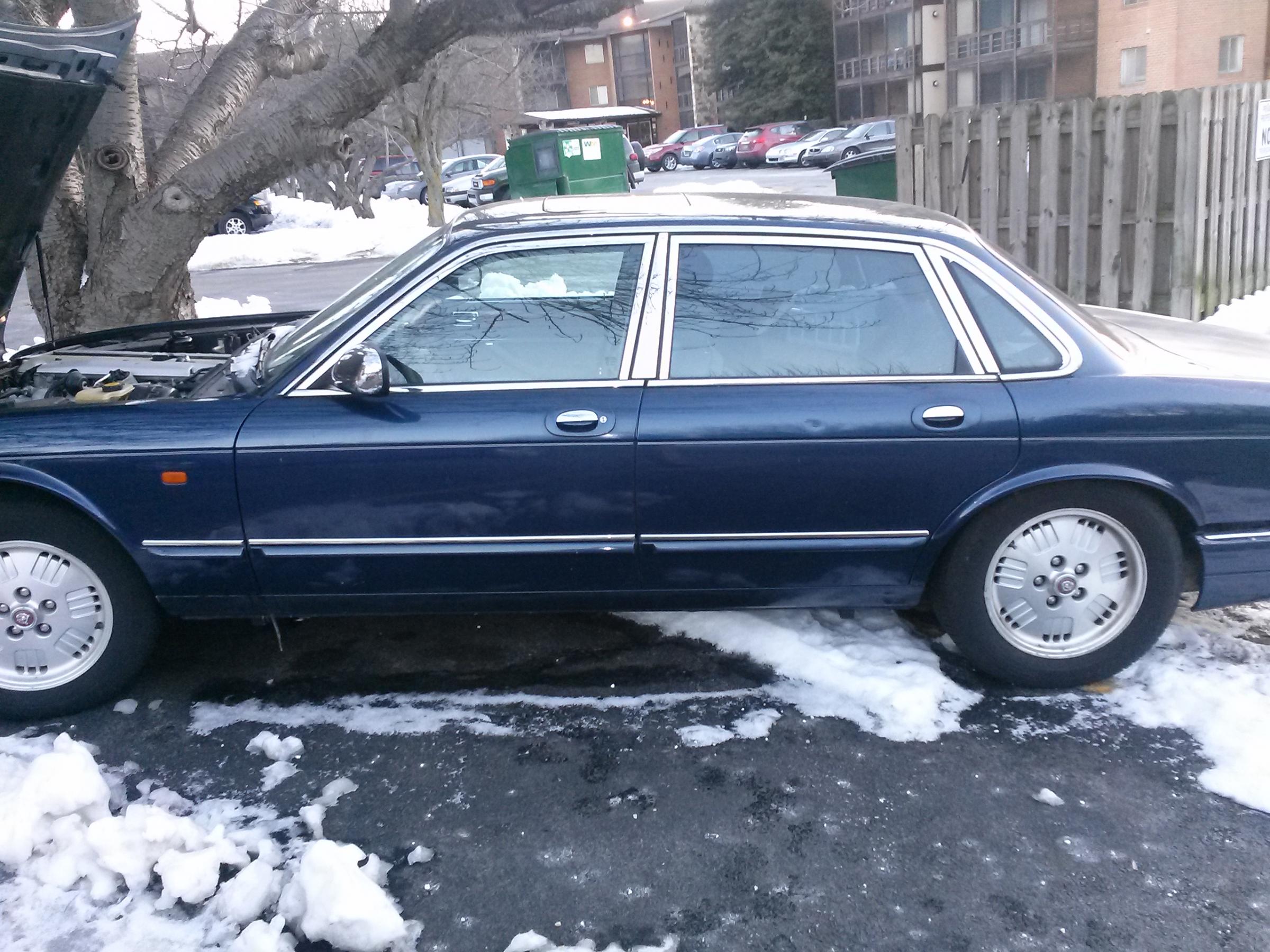

YOU GUYS LOL I CANT, well I did just get married on the 2nd...... lol anyway here are the side profile pics, and the rear seats are not heated.

Looks like a standard non-LWB to me.

I hope you and your new wife are short, you have a regular WB

Yes my friends, I concur. Short wheel base. In the USA, most of the 95 model year Vanden Plas were short wheel base, except for the very late 95s, starting with VIN 746814 (according to JDHT). So yours could have been a LWB, but it's not. I don't know why, since your VIN is 747xxx!
On a positive note, less space = closer snuggling. Congratulations!

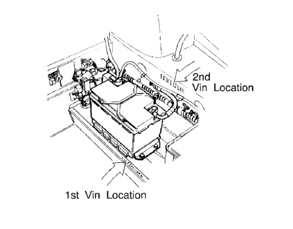

Richard,
Thank you for that very useful information.
I knew US vehicles often have an 'alternative' VIN but didn't know the original factory VIN is still left visibly stamped next to the battery.
Most of the online VIN lookups are for the 'alternative' US VIN and therefore useless for the Rest of the World!

See, and this is why I like this community so much you guys are so enthused! Well fortunately for this discussion i have to replace the battery because Its nice and swollen. don't worry I'm replacing it with the group 49 H 8 batteryand I will look at the super secret number while I'm in there feeling around

The decode of my USA trio "secret VIN" is accurate with the exception of the 11th digit for emissions type. The sixes show 'S' there and the twelve shows 'T'. That could be specially for USA emission cars, with the 4 cat converters, air pumps, etc.
Interestingly, the XJ12 has 'M' at the fifth position, which is 'Majestic'. I don't really know what that designation means. I suppose it applies somehow to non USA cars. Still it is a lovely way to describe the car!
