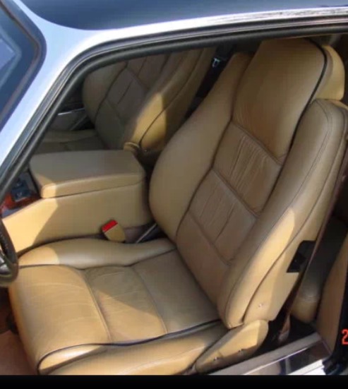

These are 94 V12 seats from a sample car:

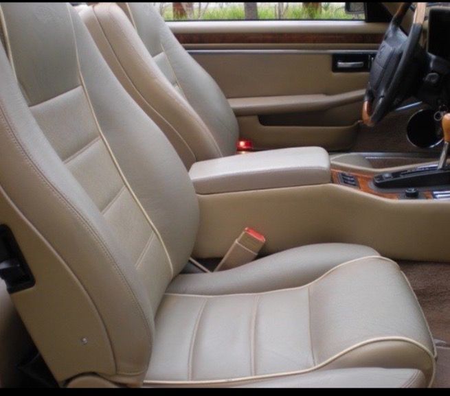

And these are 95 seats from a sample car :

As you've seen,the early 6.0 litre US seats have a different number of panels in the cushion centre and the seat squab. The 6.0 litre had Autolux leather (which is a ruched type). Also had piping which was then brought back in again as standard on the Celebration VIN range. The early US 6.0 seats also don't have the front map pocket.
If you look at the changepoints for the seat runners, there are no changes after VIN 188105 which is April 1993 (you call it "1994 MY") when the big bumpers became standard and the factory 6.0 engine came in.
Therefore, I would strongly suspect that all the framing etc on the early 6.0 US seats is exactly the same as the post-194775 seats fitted in all cars. I bet the covers will fit your seats fine! The only point might be whether the foams are contoured to match the number of centre panels. I'm sure someone here knows if the foams are plain or contoured?

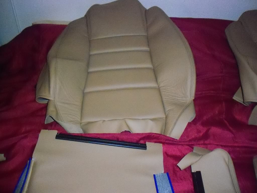

These are 94 skins I just bought. Notice the it's 3 pieces instead of one!!

Mark,
Are those 3 pieces of the backrest completely separate? If so,I'm wondering how it all holds itself together? Perhaps they have to be stitched together at their rear seam before final fitting?
It would be all to easy to assume that you can just cut the side parts of the foam off to allow them to be fitted separately to these separate side bolsters. I guess you need someone to respond who has actually taken one of these seats apart and then it could be compared with the internal foams of a "standard" high-back XJS seat.

They are indeed completely separate!!
I need a source to get some 94 V12 seat foams.
Or would an an upholsterer be able to fashion what I need for these to fit? I really have no idea

That's the entire problem. I have 94V12 seat skins which are 6 pieces per seat
Well I talked to a few people and it seems like it's very possible to install the the leather by either fashioning new foam or more likely using the existing foam and just fashioning that since it's so close.
