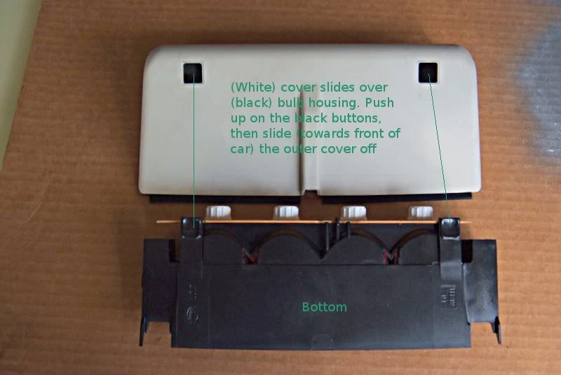

The brake light that sits at the bottom of the rear windscreen was sagging on one side, so I decided to get out there and fix it. The following is a (mostly pictorial) step-by-step guide to fixing it.
This first photo shows the outer housing and the bulb housing:

This photo shows the two housings from the rear view. The mounting tabs are adhered to the rear windscreen. The black bulb housing slides down onto these mounting tabs, then "snap" into place. To remove the black housing, push down at the bottom, then slide up. Finally, the outer (white) housing slides over the black bulb housing, and snaps into place:
