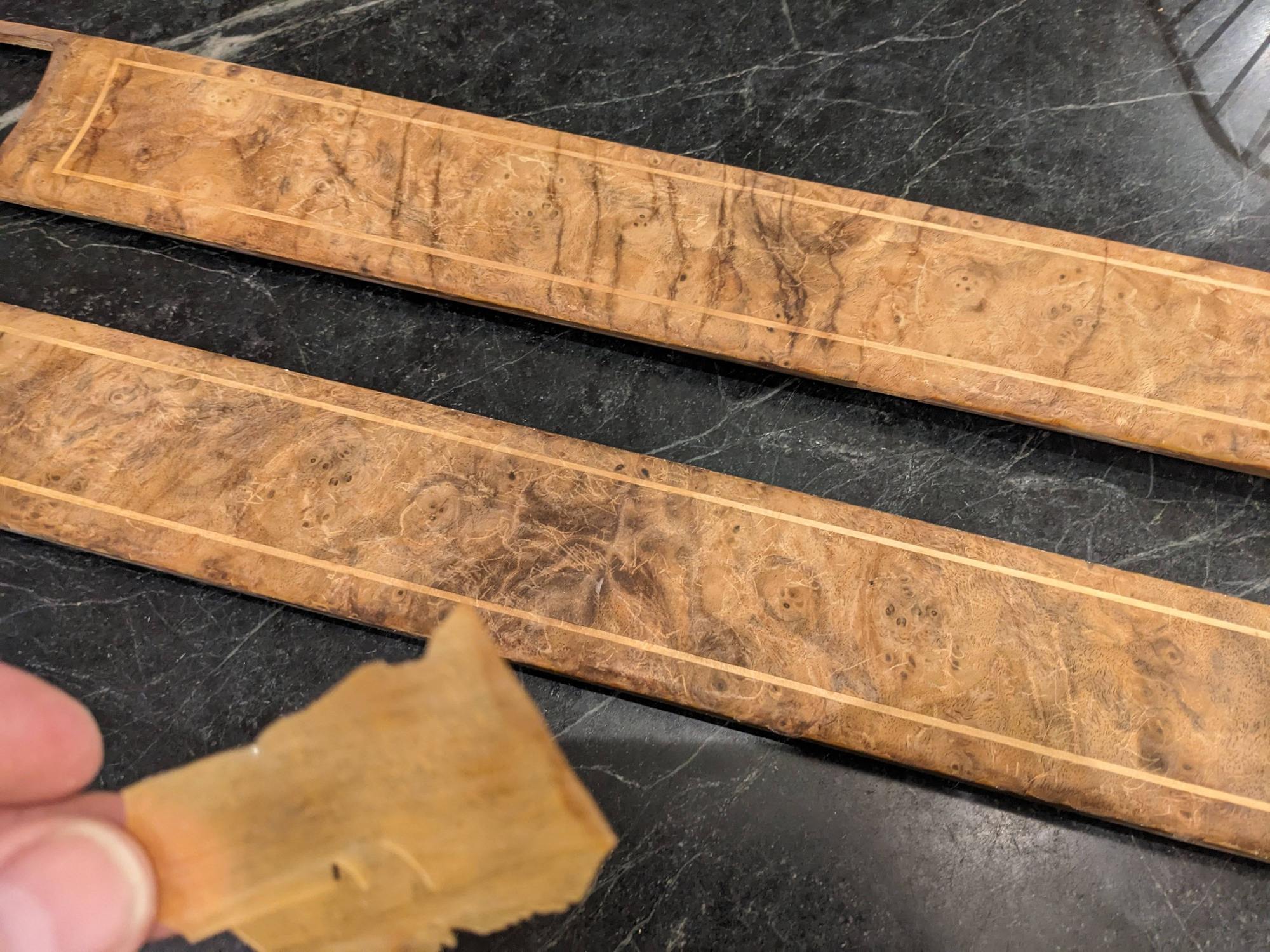

Here's the two stripped door panels and a chunk of the semi opaque clear coat I chipped off.
Those vertical stripes on the wood grain are where either methylene chloride or acetone trickled through the uv damaged cracks in the clearcoat, they should sand off (I hope).
Some areas come off easily, others really put up a fight, I also used a fresh stanley knife blade horizontally in some areas. Fairly fumey job, ventilation would be good.

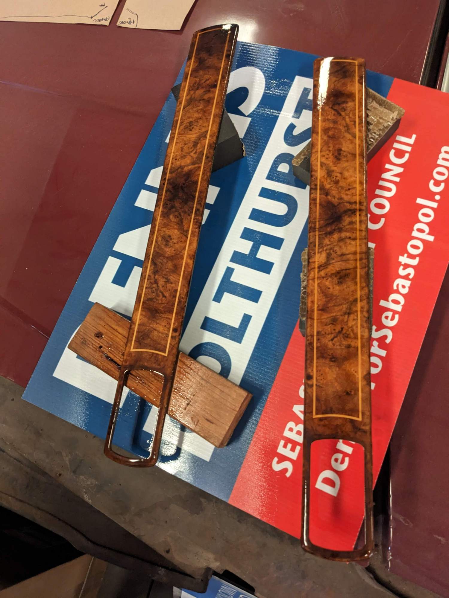

I cleared the two stripped test mules a while back. The one on the right above I sanded back with 1000 and went right back to the wood in some areas, one on the left above I left without wet sanding, it was bumpy but not much orange peel. Just cleared them both again today. Def seems to be better to wet sand before more clear. I'll probably wet sand again then flow coat them (added reducer so it goes more glossy) for a final coating.
They need quite a bit of clear on them to get a good finish (and i suspect to protect the wood from UV)

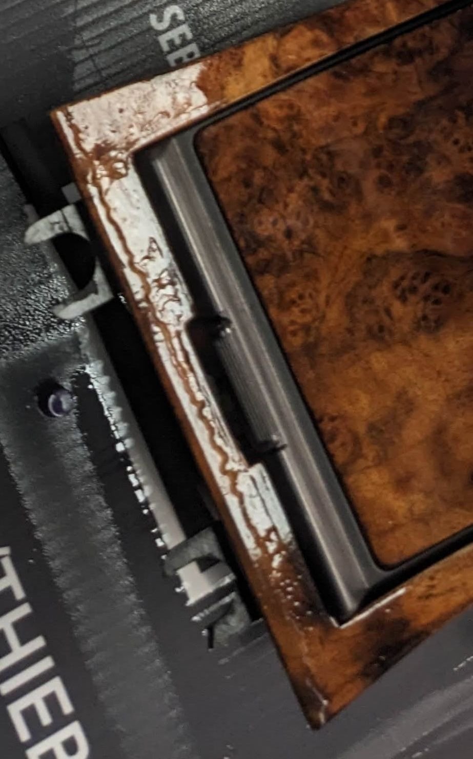

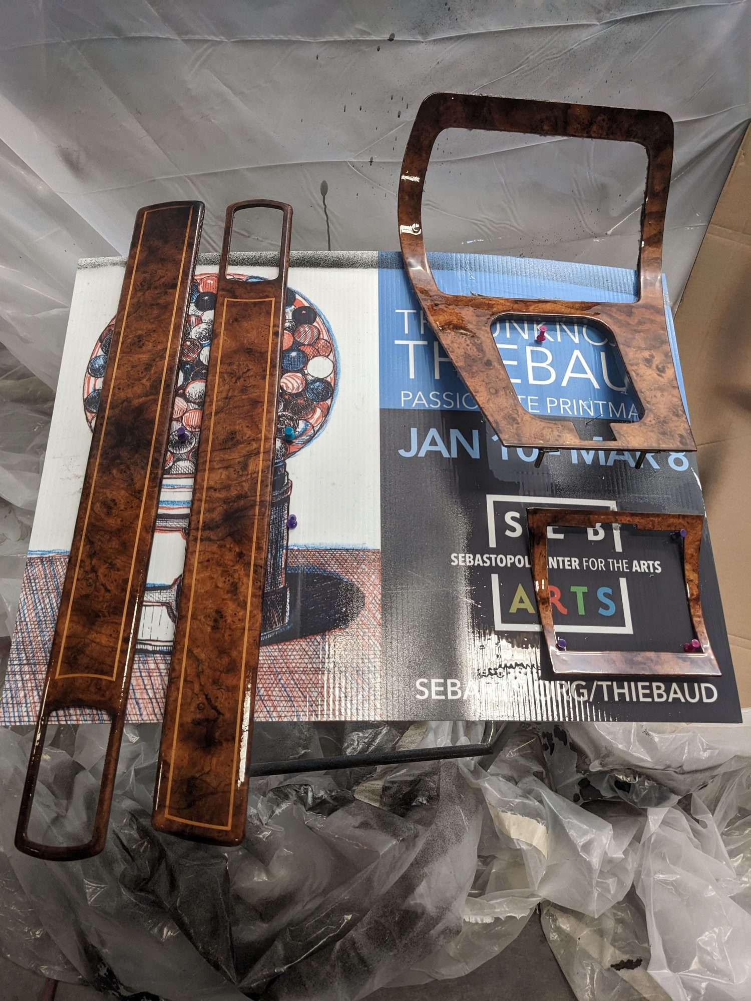

Quick update on refinishing. I decided to to redo the ashtray and ski slope as the door strips made them look really bad.
Same heat and pick off technique as I mentioned earlier in thread with the caveat that anywhere that wasn't uv damaged - the area above the climate control on the ski slope and anywhere that was shielded by plastic parts were both much darker and also much harder to get the old clear coat off.
Some of the areas that will be covered up you have to leave to deal with later.
I cleared the various pieces 3 times after getting all the old yellow coating off, sanding off each time to smooth out orange peel and crevices.
Once it had the coats of clear on it I dry sanded the bumpy edge you see in the picture above with dry 320g, went through some finer grits then cleared again
This eliminated the ragged edge and smoothed everything out. It's quite a bit of work but makes a huge difference.
