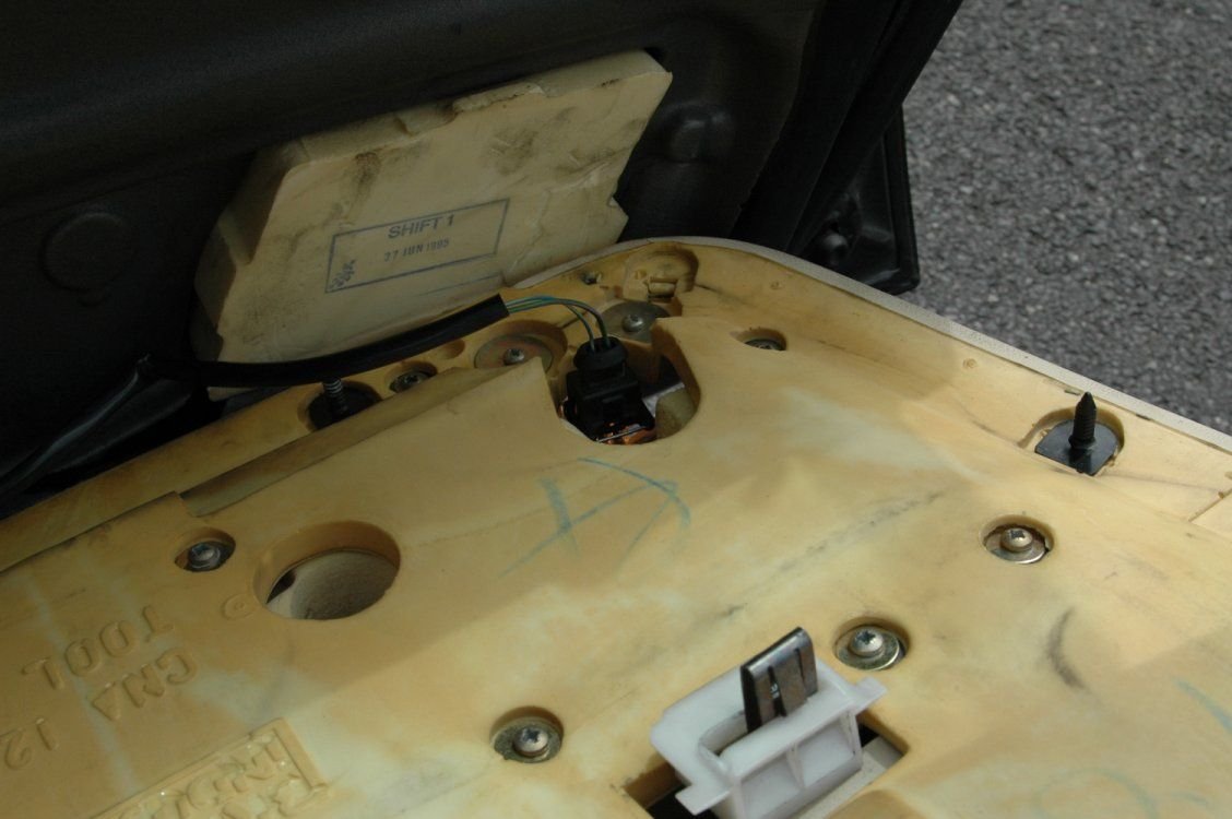

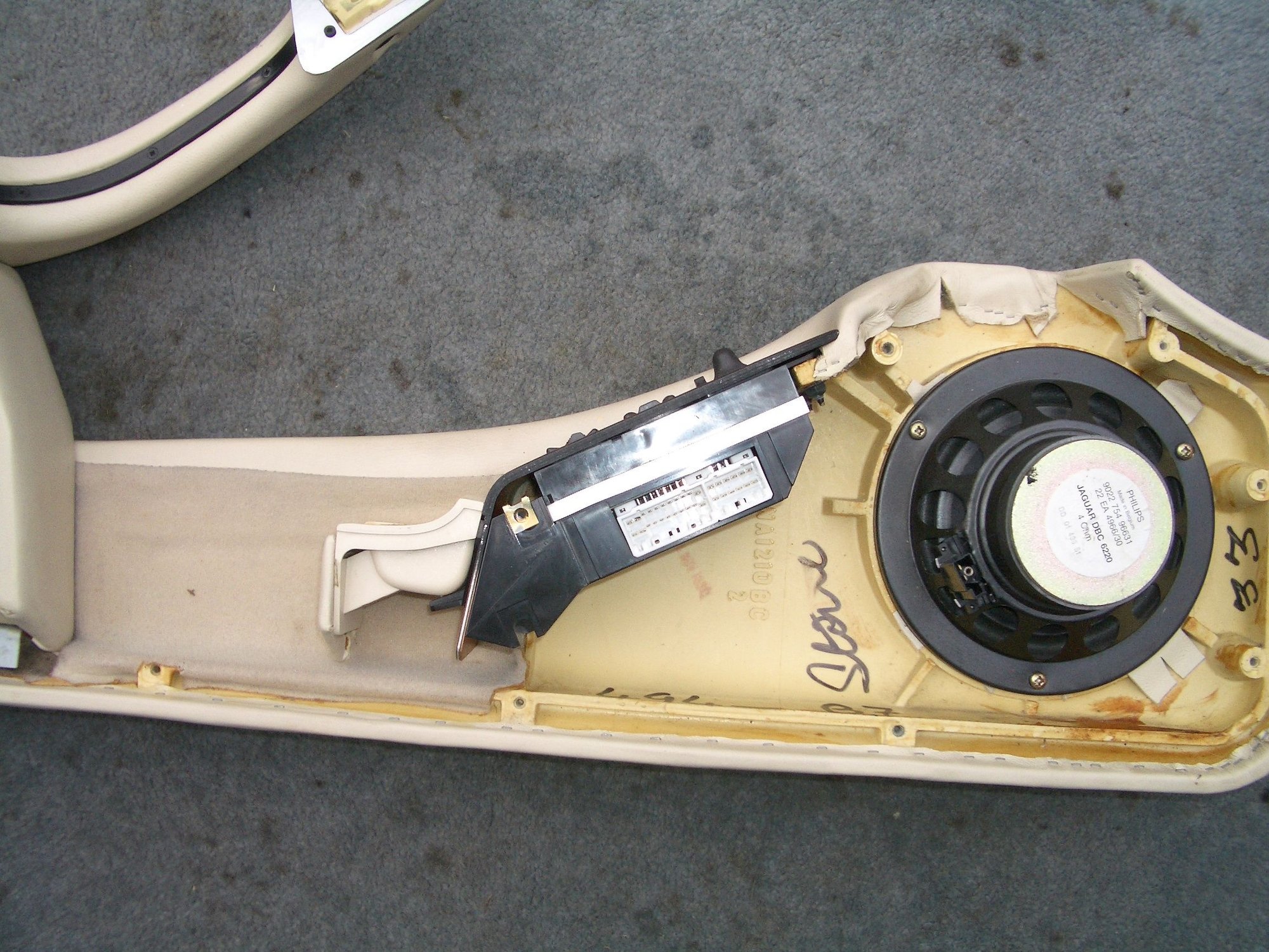

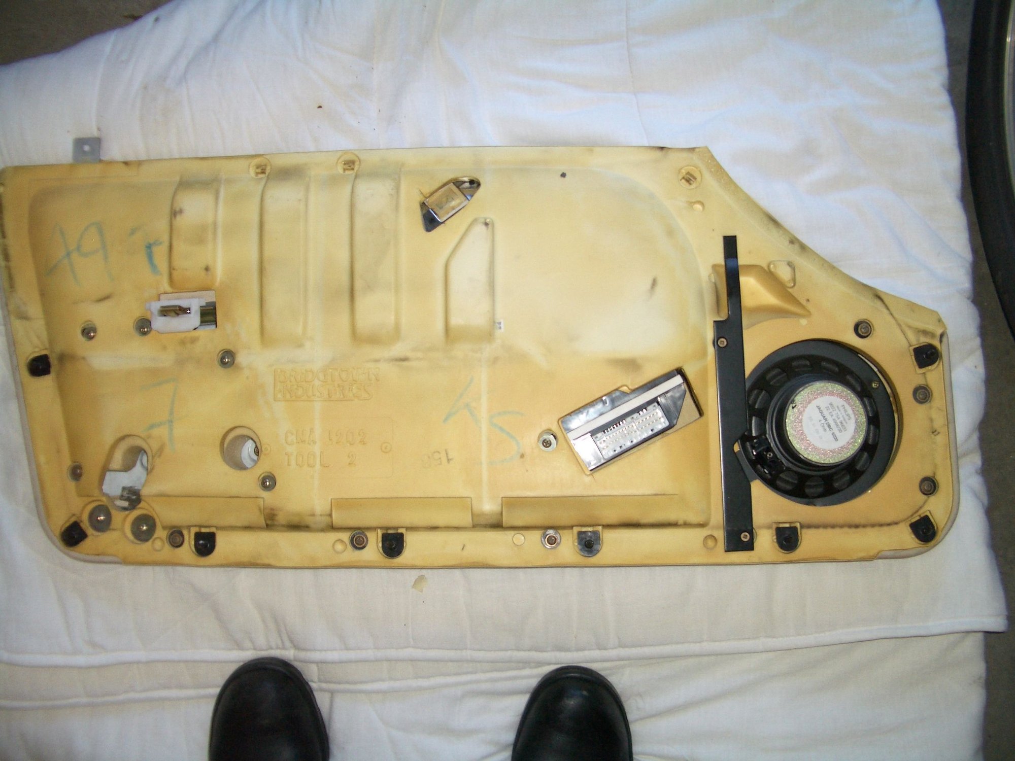

G'day Winalot,
To get the switchpack out you have to take the door panel off and then also remove the door panel side pocket. Take pix when you do it so you can replace the screws in the correct position.
See my pix attached taken when I replaced all door speakers.
Jeff.
Back of RHD front door panel.
Back of RHD front door pocket.

This was one of my first Jobs when I first purchased my X300. in my case, my RHD mirror control button/leaver had been snapped off. I purchased 2 second-hand switch packs and to replaced it. The first one I purchased from The USA in my eagerness, not thinking about the LHD issue so had to purchase a 2nd and still have a spare I can never use. To be honest, I could have just jammed any kind of appropriate looking lever in the hole where the original had been and the mirror would have been operable, but I was hell-bent on having everything perfect. there are some great step by step tutorials around and I will only add that there is a white bracket sitting in the door frame that has to be lifted vertically up before pulling the door panel off, You can see it on earlier pictures shared or towards the bottom of this one
Addisonly, Id also advise having some spare door clips on hand as I also managed to snap a couple getting the pannel off
