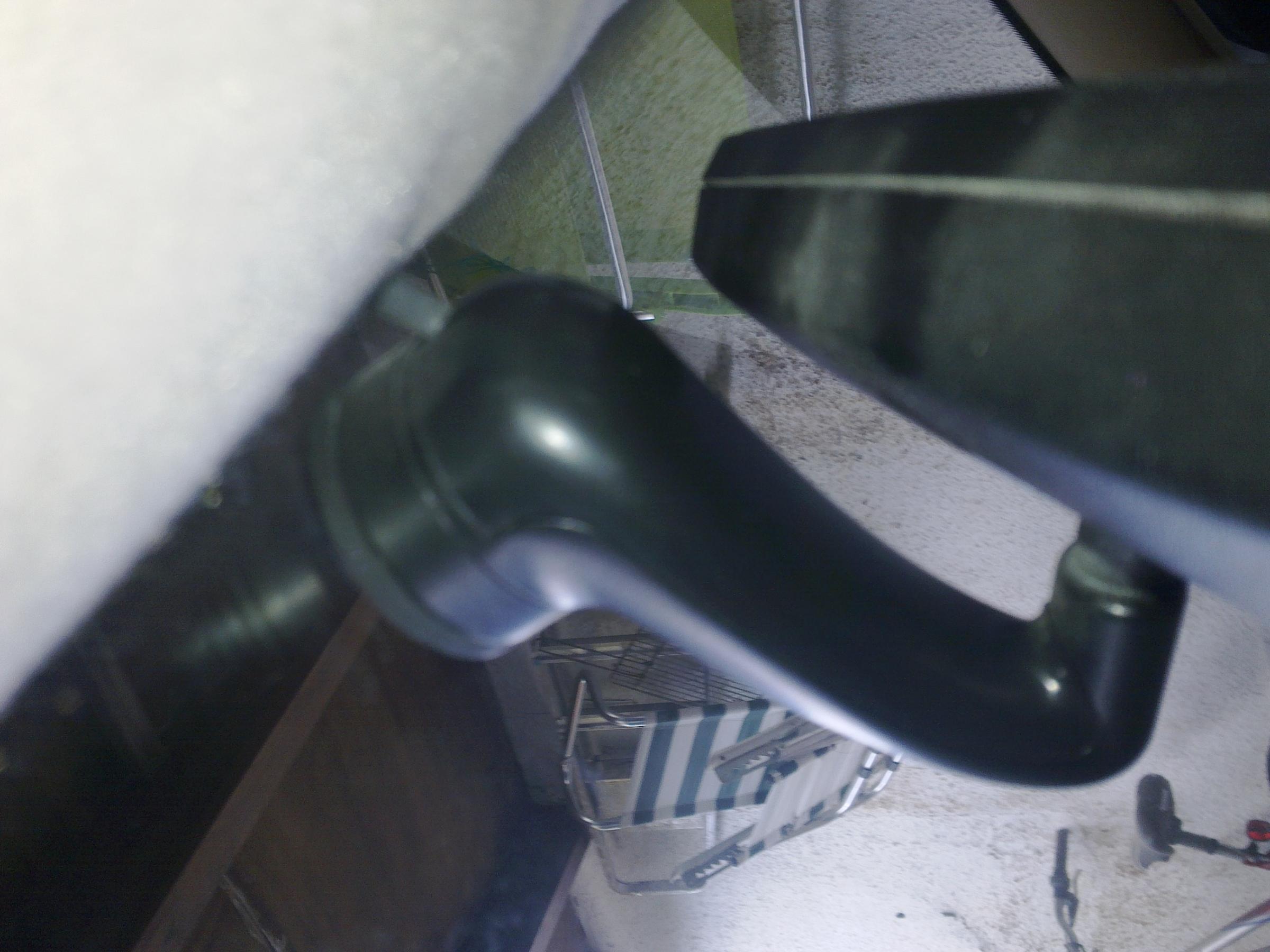

Once you have the mirror off of the windshield, it is possible to disconnect the mirror from the stem. I just did this on our BMW using a ball joint fork or separator like this:
I inserted one tine or prong of the fork on each side of the ball stem and gently pried up until the stem popped out. The real problems began when I needed to press the stem ball back into a (different) mirror. The first time I tried it on an old mirror I did not intend to use, things went well. But when I pulled the stem out of the old mirror and pressed it into the newer mirror I wanted to use, the manual dimming mechanism inside the mirror popped free from its clips inside the mirror, necessitating a lot of tedious diagnosis and a custom-made tool to reattach the mechanism.
If your mirror is the electrical photochromic type, the ball socket is probably rigidly fixed and you should be able to carefully press the stem in without any problems, but I would recommend that you place the mirror face down on the edge of a table (perhaps with a towel or piece of corrugated cardboard to protect the plastic of the mirror frame) and slowly but firmly press the ball into the socket. After my problems with the manual dimming mechanism, I used a soft-jawed Quick Grip clamp to help regulate the pressure on the stem as I pressed it into the mirror. I hooked one jaw of the clamp under the ledge of the table top, and placed the other jaw on a bend in the stem where it could apply pressure:
Note that for our BMW I had three old photochromic mirrors to use as parts, and I discovered that the ball and socket diameters were not all the same, so the ball on the stem of one mirror would not necessarily fit tightly in the socket of another mirror.
