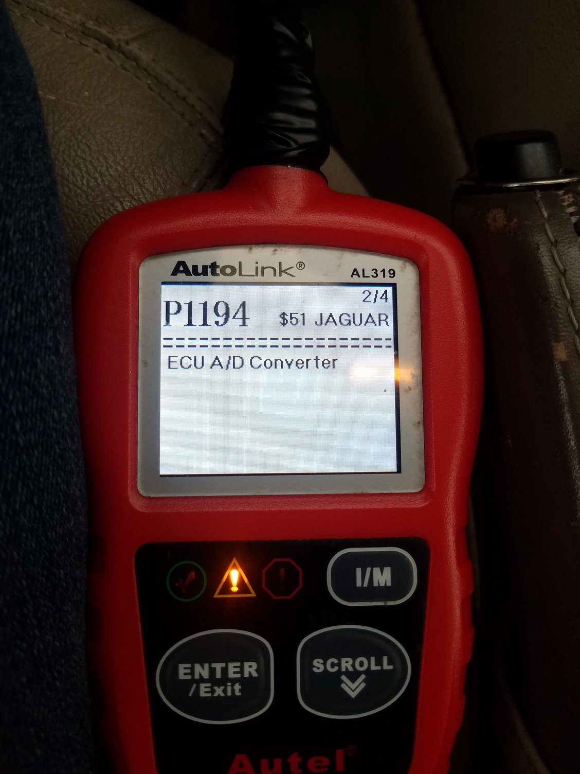

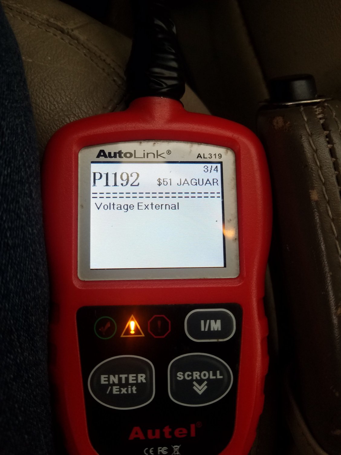

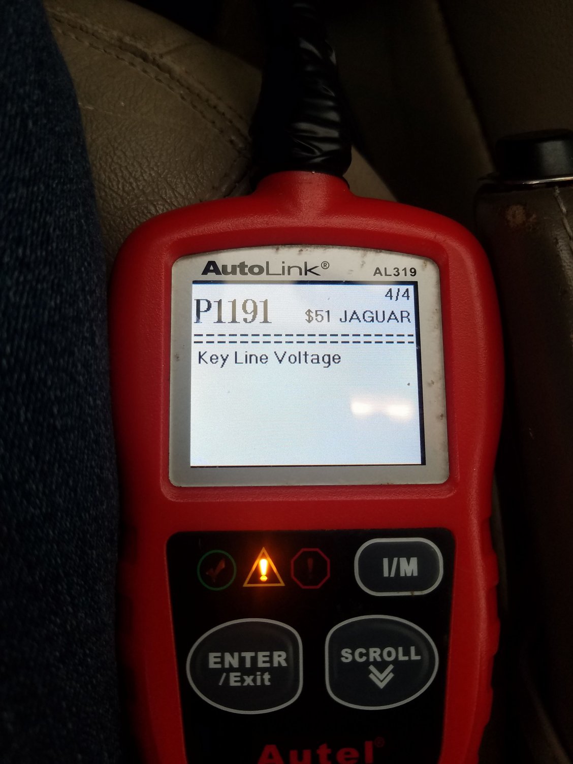

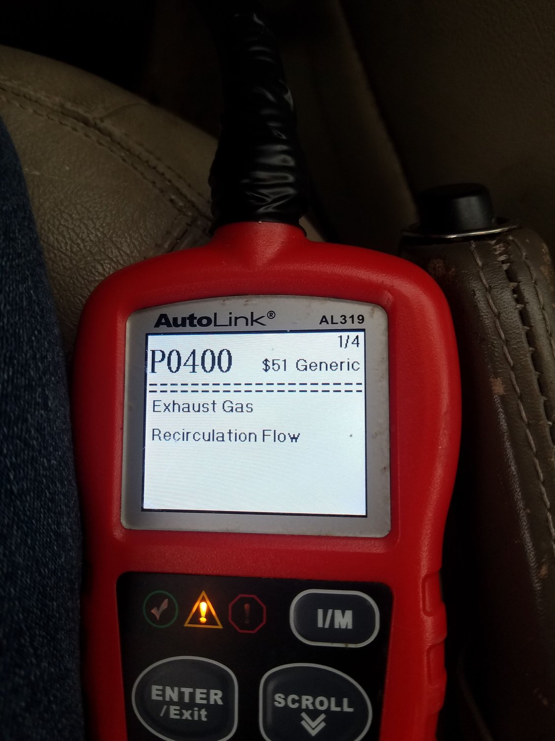

Now after all the repairs still not getting it figured out because still running like it had initially. Connected code reader and 4 codes are available
Mechanic said he failed to mark O2 sensors where they were on old downpipe for when replacement one was installed.
Could this be the entire issue with my rough idle and running rich? If so, it still doesn't explain what made the hole in valcue cover that started the problem of rough idle initially.

Code P0400 for the EGR probably means it is very dirty and possibly clogged or otherwise failed. That could cause rough running. An EGR recall (R493) was ordered and you should have a visible label above the radiator if it was done sometime in the past. The update made the EGR valve cycle after engine shut off to help keep it cleaner and operating freely.
Codes P1191, 1192, 1194 are all related to the downstream O2 sensors. They were either damaged from the repair or connected improperly, as Brendan said. Certainly a cause of rough running. Your scan tool doesn't describe the P codes very well, not even mentioning the O2 sensors. Code 1192 is for O2 heater short circuit. Codes 1191 and 1194 are for O2 heater resistance fault. I think this is the most likely cause of your problems now.
