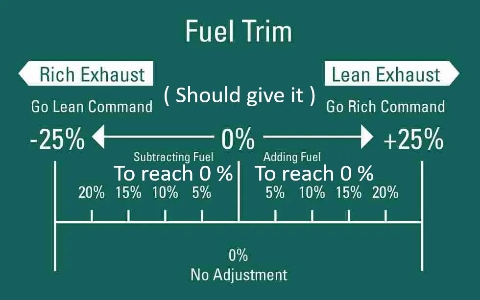

Your most important parameter IDs ( PIDs ) are :
Short Term Fuel Trim bank 1
Short Term Fuel Trim bank 2
Engine Coolant Temp ( this determines if the ECU is going into full fuel trim / mixture after warm up and O2 sensor reading so the ECU can calculate proper fuel trim for smooth running as well as emissions )
RPMs
There are a few examples of X300 contributors with their graphs if I can pull them up
OBD2 live gauges displayed to tablet? - Jaguar Forums - Jaguar Enthusiasts Forum
Later you can observe the O2 sensors as you reformate the PIDs ( this takes some time as a learning curve ) but in the final end product you should have close to 0.0 % STFTs through all ranges of engine load and RPMs , + or - 3 % more realistic limited by the refinement ( data size ) of your data " maps " or data arrays in the ECU

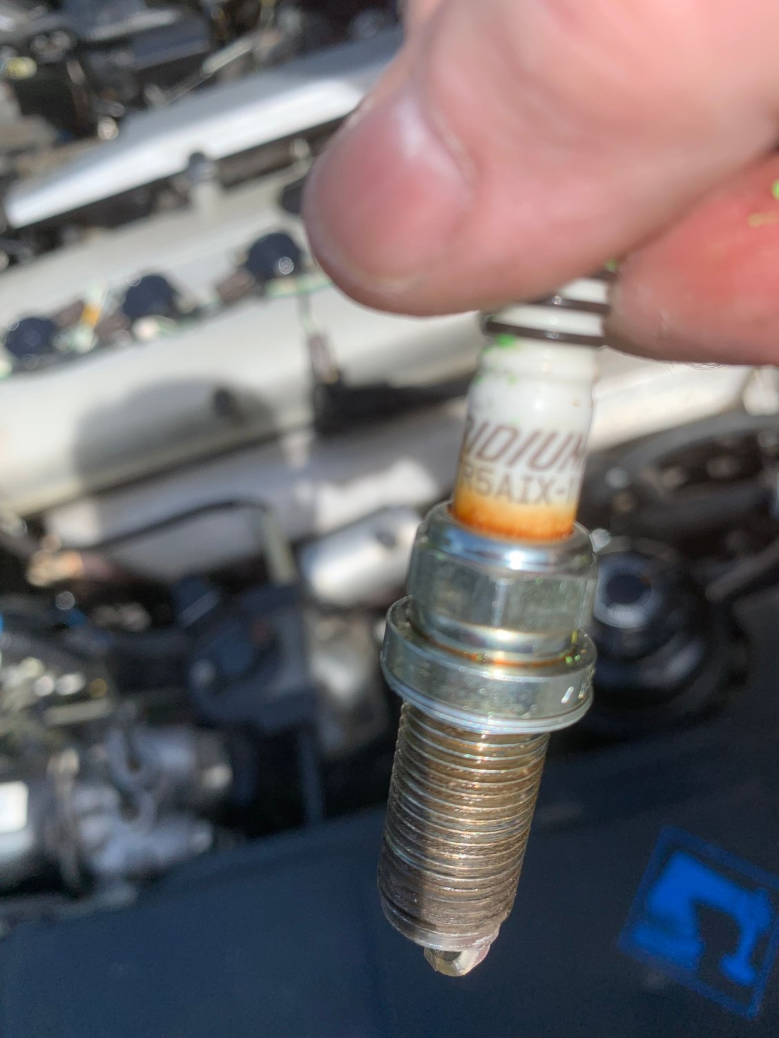

I just pulled the plugs to have a look. They have less than 10k miles on them. They have this orange ring on all of them.

BTW, these are Iridium plugs. I may just go ahead and change them to copper. What do you think?

There is a TSB on the correct plug of the cheap Champion copper # x , no exotics like platinum or iridium , there was some gap differences in TSBs though the years
There is a TSB on the staining ring but my not be an issue with correct plug

The orange on the plugs is called Corona stain and is nothing to be too concerned about.

Also, spark plugs need to be copper type. Too many posts report issue when using iridium, or other exotic plugs. NGK BKR5e or Champion 71 (RC12YC) should be what you need.
