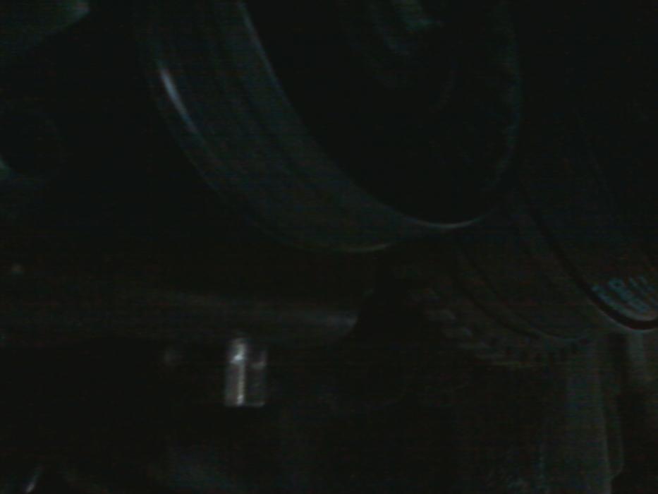

I recently put my a/c belt on my car and ever since then I've heard a squeaking sound coming from the hood of my car. Before the belt initially snapped the tensioner used to come loose all the time and cause a horrible screeching sound when running the a/c until i tightened it, Which i attached a picture of. Recently the squeak got worse and when I step on the gas it turns into a loud screeching sound until it stops at about 45-50 mph. I tightened that square screw in the attachment hoping that would do the trick like usual but to no advantage. Any ideas anyone? sorry for the long post and thanks in advance.

Sounds like that "square nut" adjuster is not doing what it should, maybe the lock bolt is not locking the assembly once the adjustment is done????.
OR, the plastic idler bearing has siezed and needs replacing.
OR, the other belt is squealing.
OR, the vulcanising of the front pulley is parting company with its parent centre piece.
OR, the a/c compressor is siezing and causing whatever you do to squeal.
Some quiet investigating is required, eliminating on item at a time.
