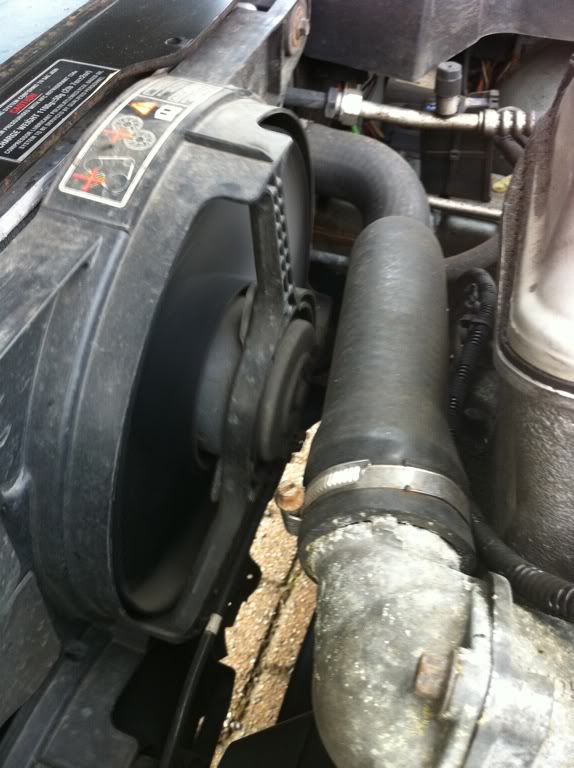

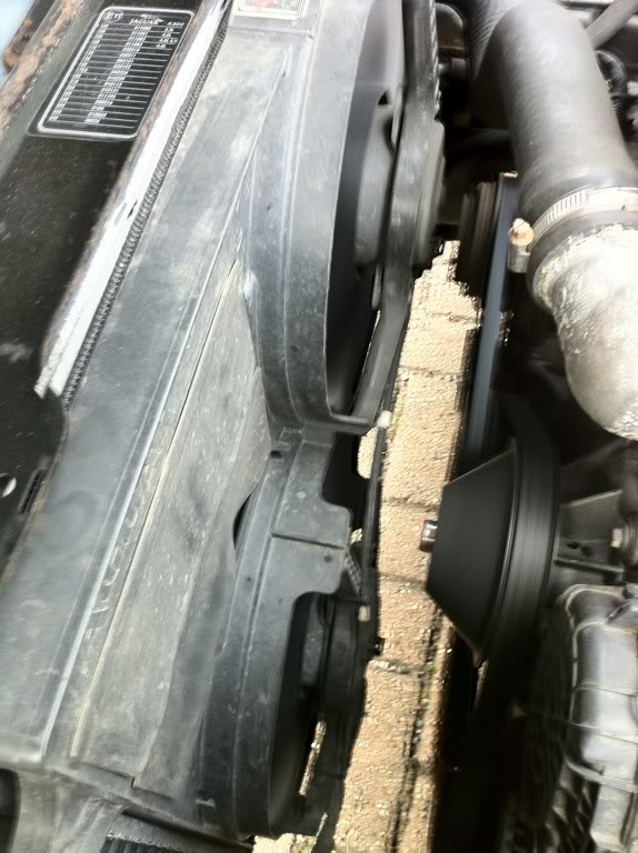

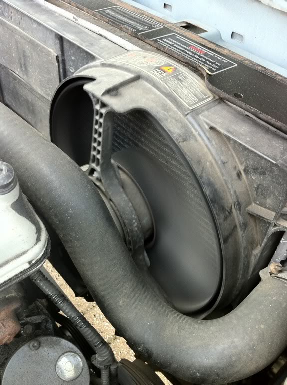

Checked it out at lunchtime and this is the fan that was checking once it warmed up though it stopped driving home it didnt shake
Is the actual fan mounted on a fan motor and the bearings could be gone or something.....
Again you more senior guys i welcome your input please
There are two radiator [cooling] fans. Certainly, if the fan-blade itself, the bearing, or if the motor-mount is loose ... any of those could cause vibration. The fans are controlled by various input, such as ambient temperature, the A/C system, and so on.
Your could simply touch the [cooling] fan's motor mount with a thin rod to see if you can "feel" the vibration. You might also, when the engine's been off for a while, check all the cooling-motor's mounting hardware is secure.
The images obviously show the top fan is the issue, strangely enough its been behaving all week.... typical when you want to diagnose something.
Anyway the mount was fine, but fan blade shook/wobbled on what ever it is monted on very slightly what is the part name anyone ??

As members kindly gave me some input on my thread.
I thought Id give some feedback on to what was diagnosed.
The vibrating with the fan area was diagnosed as the air con bearings have collapsed will I be able to buy these seperatly or will they come in the air con unit?
Genuine Jaguar Parts and Jaguar Accessories for Classic Jaguars
The vibrating on start up etc was diagnosed as a collapsed right hand Cat.
