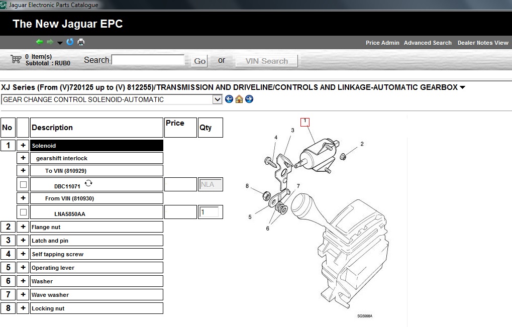

If it is the Interlock Solenoid failed, then a.f.a.i.k. this is only available from the dealer:
I've had a nasty shock with these in the past. The original solenoid was around £32 but was superseded by one at an eye watering £230. I expect US unit cost to be even higher.
Good news is that any one from an X300 will fit so you aren't restricted to the same MY when searching at a breakers.

New solenoids are over $300 but you can find used ones for $50 or so.
