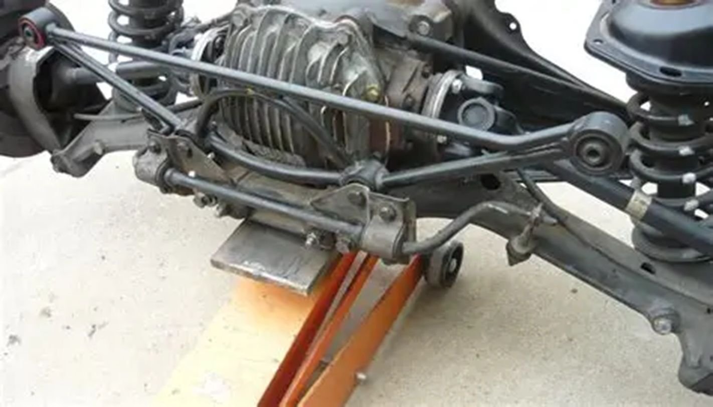

There is on the rear the more solid X308 crossbar that can be and has many times substituted ( can be done without rear suspension removal and just " slipped in " ) there is a little hardware difference
See item 13 on this X308 , Bushed differential strut part # MNC3713AA for the softer bushing and MJA3713AD for the harder
Xj 1998 - 2003 (from 812317 To F59525) (x308) Classic / Wishbone Assembly | Jaguar Land Rover Classic Parts
