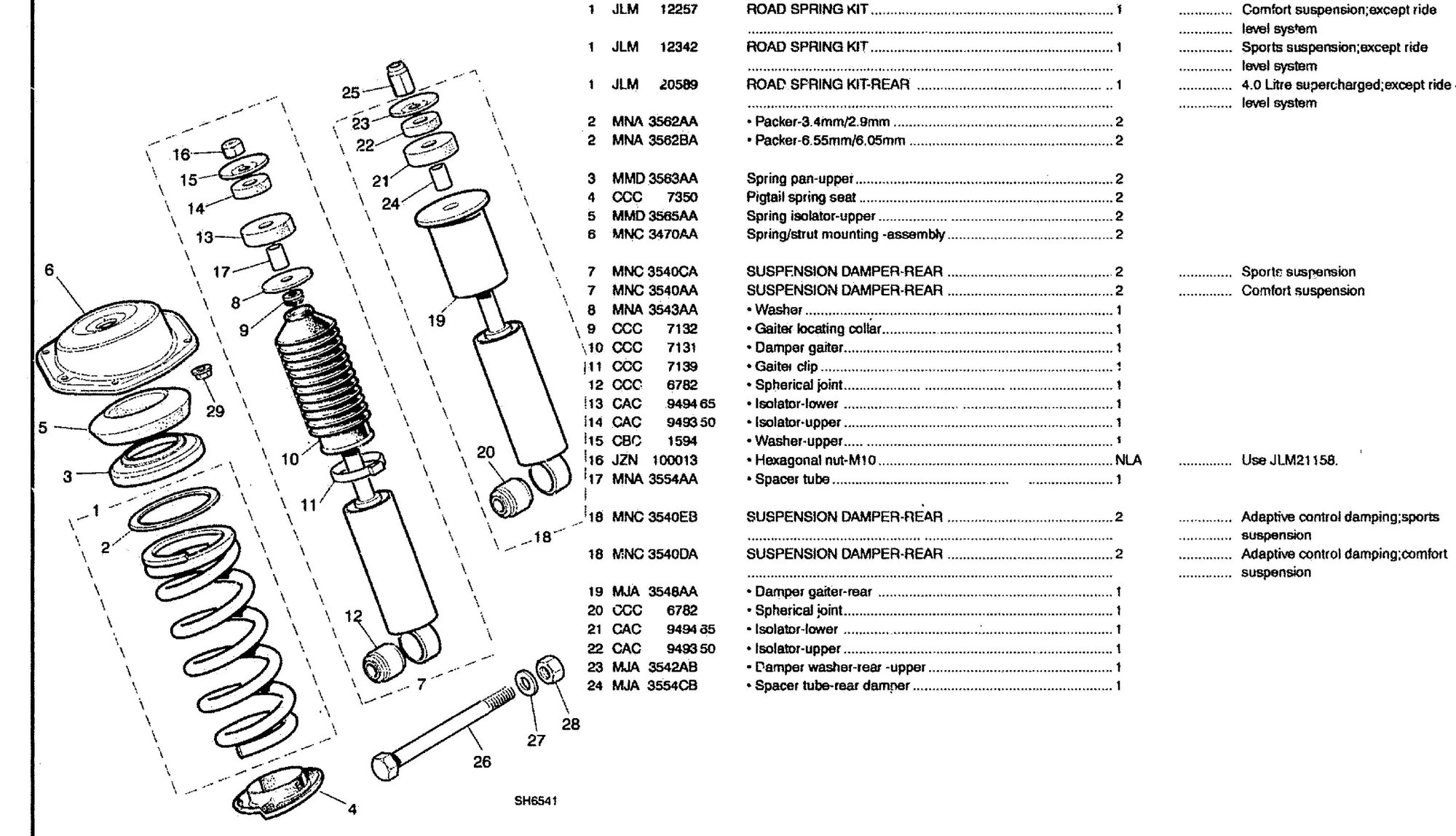

I'm talking about the yellow foam parts on the top of the rear shock in the picture. Is there a specific name for the part? My shocks are good but my donuts are collapsed. I have new donuts to put in. Guessing the foam on top of the shocks also collapsed. Have searched at my normal part suppliers but can't find the foam part sold by itself.

Damper Isolators.
Upper = CAC949350
Lower = CAC949465
I have found that the Jaguar dealer is more cost effective if you have a commercial account and get jobber price.
Look the cost of the parts with the ACTUAL part number.

Adding things to my long term shopping list as I get a lot of racket from the rear suspension and suspect if its not all original, its pretty damn old. If I were to replace the shocks, am I correct in that the typical other wear and tear parts I should be replacing at the same time are the set of isolators at the top and the spring isolator? Parts # 13, 14 and 5 respectively? Any other bits in this assembly that are "might as well change them while I'm in there"?

New dampers come with #13 and #14.
You just need #5.
I bought a car from Previous owner that had new dampers installed and re-used the old spring isolators!!!!!!!!!!!!!
I have to drop everything again to replace them. (grrrrrrrrrrr)

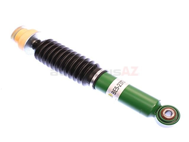

Looked closer at shocks. The lower bushings on my back ones were degraded. Also, they are black. The front KYBs look fine but the webbing at the top of the bellows had fallen apart so guessing pretty old. Not sure if KYB are comfort or sport. Better to have the same all around so went with Bilstein green plus SKP front bellows and bump stops. Checked around for prices. As usual RockAuto cheapest.
