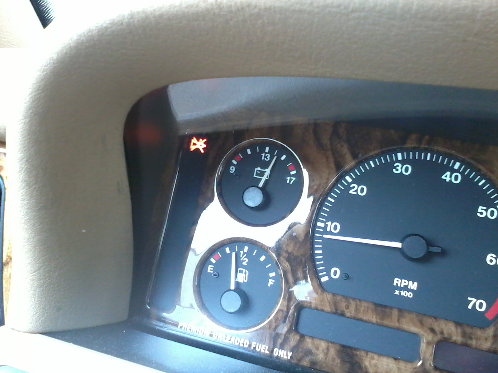

Maybe I'm wrong about what the light actually means. But here is a picture of it.

Looks like a transmission fault indicator. I did a lot of searching for you on this and lots of people have asked this question on the web and no one has really given a definitive answer. Without an original owners manual it is hard to tell.

AFAIK (and someone with more experience will be along to confirm / refute this shortly!), the transmission fault indicator is probably coming on because the engine has stopped, rather than because of any fault with the transmission itself.
I had the same problem as you - in my case it was cured by replacing the plugs with the factory specified Champions, and cleaning out the TB.

I agree with Ziggy. The light is just a result of the engine stalling. I have been having that problem for sometime. I think I am on the right track as identifying it as the throttle body TPS(throttle position sensor). They are very expensive to replace and the dealer will only replace it with a Jag unit at near $500. I have been doing a lot of research and think I have found a good substitute which is used in the English Ford Scorpio. I have one on order at $135. It has not arrived yet, but when it does I will test it against the Jag unit. The Jag TPS has the Ford logo on it and I believe it is identical. We'll see and I will post a complete summary of the results when finished. This could be a significant cost savings for all XJ6 (X300) owners.
This is sounding like what the problem is. I think I may have been stalling out because I was entering limp mode or something. I did have new spark plugs put in but I think I will be buying a better kind and replacing them again. Then I'm going to have a look at the TB once the weather breaks.
