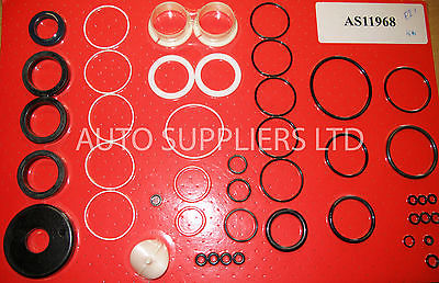

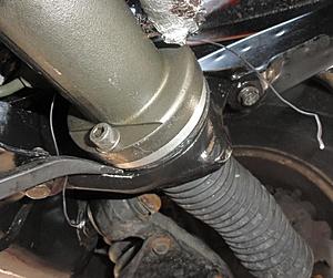

Before you were to change out the rack , by replacing the fluid you can get rid off the noise and there are external mounting shims to get rid of the sloop . The outermost internal seals can be changed for a leaking unit very easily yourself without removing the rack . Is your issue other then these 3 ?
https://www.jaguarforums.com/forum/x...-speed-183702/
There are seal kits to replace all the seals
