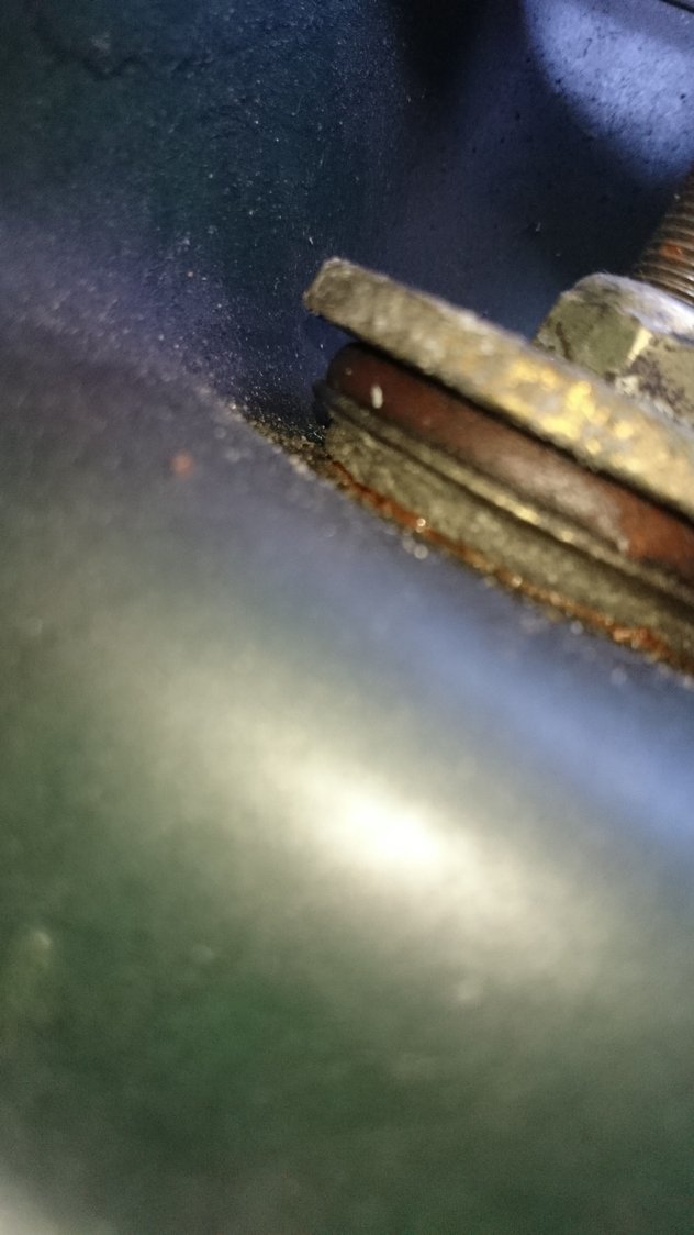

Hey,
Could someone name this thing? It causes front suspension knock, can be seen from engine bay right above the wheel.

I think we're looking at the shock absorber bushing and washers

I agree. The parts which need replaced are the isolators, 2 per side, part number MMD2144AA

That's the upper shock mount. My experience after replacing my shocks was that the lower bolts can come loose a bit (perhaps not tightened enough upon install) so check those too.

I would echo all of the above, this is a relatively straightforward job. On Right hand drive cars, the radiator header tank needs to be removed to access the LHS nut, but not difficult to do.
Whilst in the vicinity, it is worth checking the bottom shock absorber bush too, as it is not unheard of for these to wear, which allows knocking.

The bushing can be replaced in situ. Use the two-sockets-connected-by-a-bolt method, assisted with a hammer.....
Steer clear of the cheap aftermarket bushes: mine were shredded after 3000 miles, and I had to do the job again, this time with Jag bushes.
