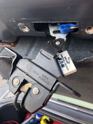

Well it was all quiet times for me since I did the tyres. Car working like a treat. Then came this week with two broken things in a matter of two days. First thing to break was boot locking mechanism. The boot wouldn't latch shut so was bouncing around over speed bumps. Removed the latch mechanism. Three bolts pulls this out. There is a large sprung mechanism at the top connected to two thick wire connectors. These push into plastic retainers. Difficult to remove - one points up, one points down and there is hardly any slack on these. Then there is a boot open sensor that has no visible connector but clips into the mechanism and can be popped out relatively easily. With this you release the mechanism from the car. What I found was a long brass coloured lever that unlatches the latch and this has a small spring on it. The spring was snapped. Quick fix for this is to using some thin wire to tie it to the main sprung lever at the top so that this bigger lever pulls it back after unlatching. Didn't take a photo of what I did but I will when the replacement arrives (£28 on ebay). I had to do the repair in a Lidl car park as I was leaving the car and had thousands of pounds of tools in the boot. Refitting the mechanism is a pain in the back side. This is due to the lack of play on the two metal rods. I found the easiest way was remove the plastic retainer for the lower rod, fit that to the lower rod first and push that retainer into the mechanism and then with some patience the top rod and go straight into the plastic retainer which in turn can be locked in place with a flat head screw driver. I was pretty pleased with my fix!! And it can only ever fail open. Obviously looking forward to getting replacement part!!

Fitted the replacement part today. Job done. The bodge held on for a full 10 days!!!
