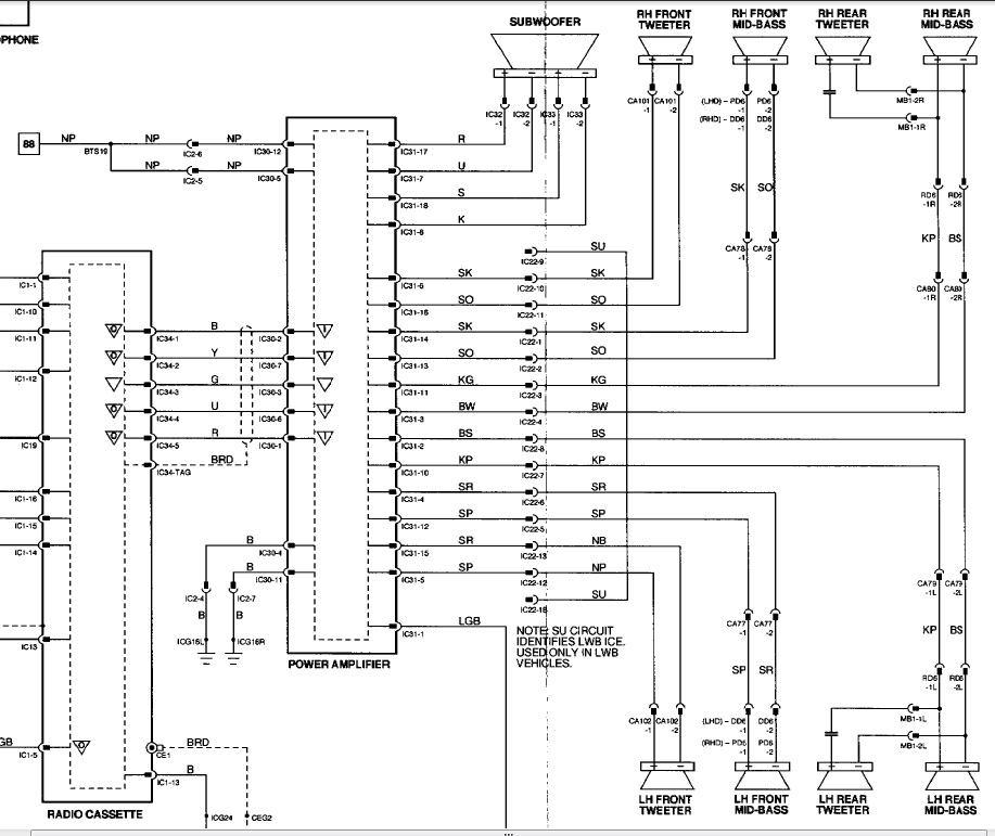

the wiring shouldnt be a problem, there is wiring diagrams for premium sound. in my case i left the head unit but added an amp. using the wiring diagrams to find all the speaker wires from the stock amp to each speaker and the wires from the radio to the stock amp. I used a small box that converts the outputs of the stock radio into RCA and those go into new amp. then the speaker wires into new amp. i left the stock amp powering the rear deck subwoofer. I imagine changing the headunit would be simpler or about the same. the only problem would be keeping the stock cd changer.

so, the speaker ends terminate at the AMP in the rear of the car if im reading all this correctly.
What if i just installed a radio in the rear of the car that has bluetooth control with a cell phone, and soldered it directly to the speaker wire ends? and maybe used a switched 12 volt source in the boot fuse compartment?
I would imagine that you could bypass the whole AMP and CD changer setup that way and not have to run wires back to the front of the car ( that sounds like allot of work) while still looking factory with the old head unit still in place.

you can do what you suggested of placing the radio on the boot, if you dont want to send speaker wires to the front. or you can use the stock amp with the new head unit or use an aftermarket amp with the new headunit those 2 options allow you to not have to throw wires from the back to the dash. you would use the stock wiring.
