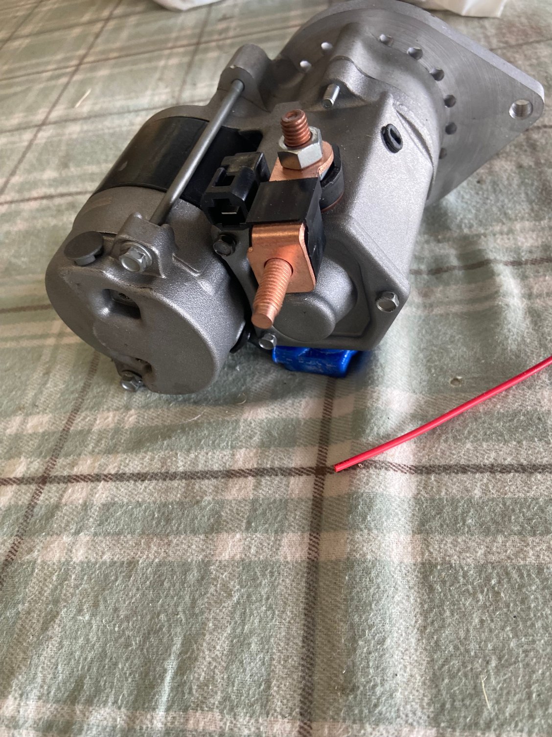

Hello fellow X300 fans,
What are everyone’s thoughts on having a gear reduction starter for an X300?
I’ve managed to get ahold of one, with the backing plate custom made to fit. The reason I’ve acquired one is because my current one seems to be playing up/giving up the ghost
I’m aware of gear reductions starters being better for older, older cars with massive starters, but this one was well priced and could serve as a good replacement.
let me know if you’ve had any experience with this sort of thing or if you’ve got any insight. Cheers
Below are some photos of the starter, along with a comparison next to an old Bosch motor from an XJ40 for size.
Older XJ40 motor left, new gear reduction right.

It looks from the photo as if the gear will constantly be engaged with the flywheel. Is this correct?
I believe the gear is in the retracted position. As is my broken Bosch one next to it
