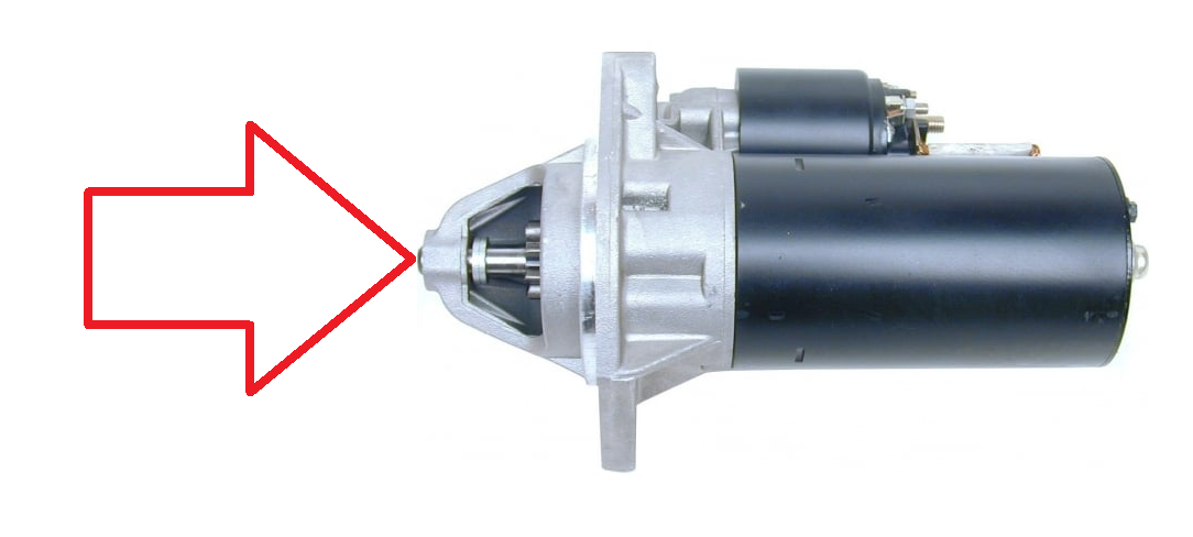

What I found with mine was a unhealthy sound as the starter rotated
This was from a bushing missing on the nose of the starter allowing the gears to walk away from each other and not fully engaging on the face of the gears
This is different then the gears translating into each other and a failure of the solenoid shoving over the starter gear , this is a loud drive you nuts stripping noise and will sometimes not allow the engine to rotate
The bushing can be replaced but you have to remove the starter
I did not notice wear on the gears
